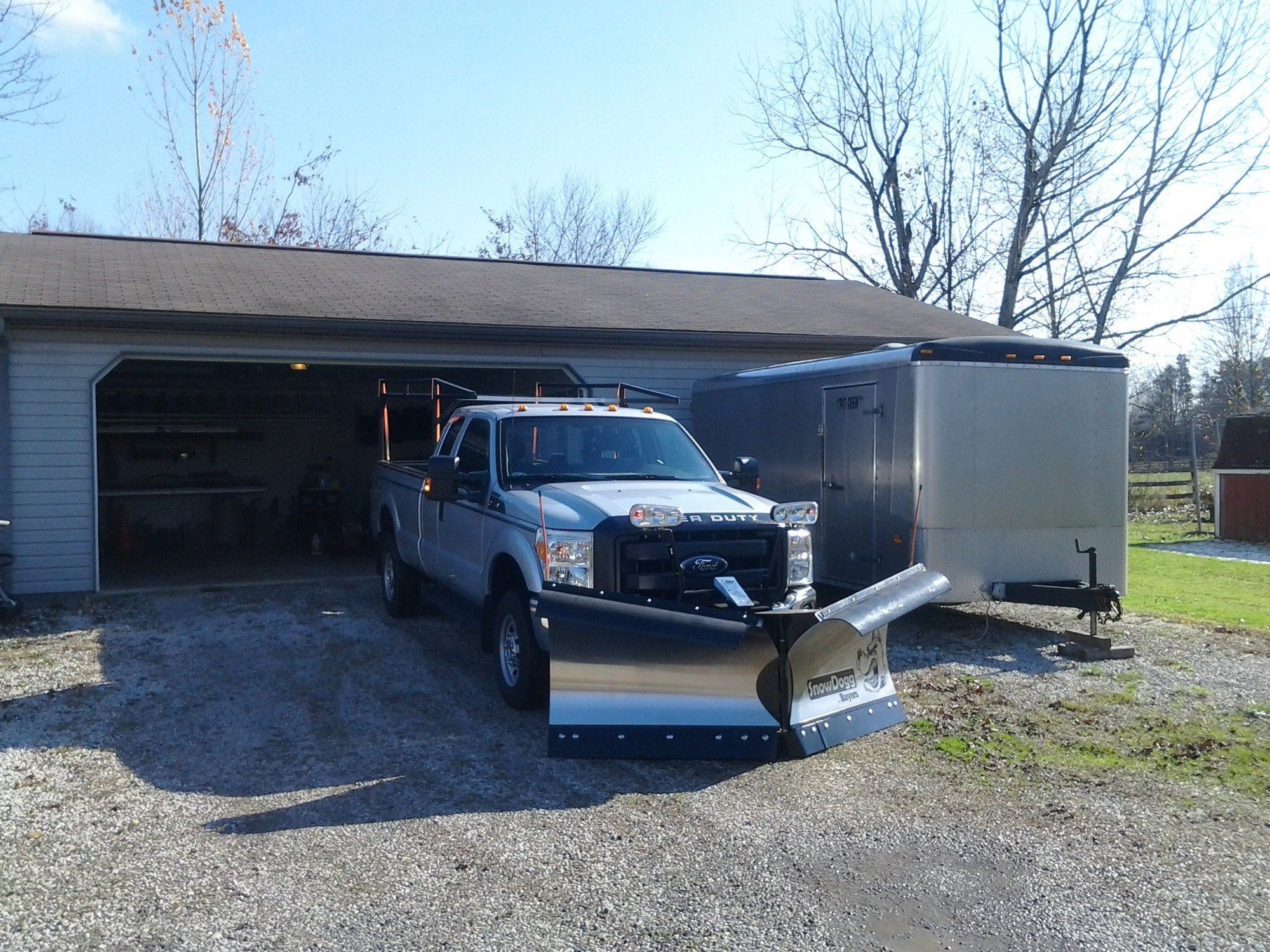

Well the plow is on,and yes I have the differential lock option and didn`t even know it, thanks guys. Fordman, yes there is a pic of rear axel on the ****. Didn`t even pay that much attention t om it. Haven`t used 4 wheel drive yet. Got the truck in March,plow also. Loking forward to using it. the **** dosen`t say pull.
