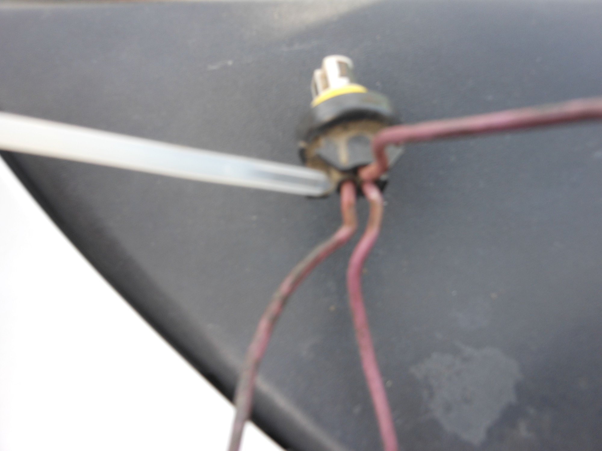

this is my ICP pig tail see the white , this was shorting out making the truck surge stall out and with high low rpms Intermittent.
Dang, don't have a voltmeter and not sure how to use one if I did. Wiggled the ICP connection and never got any voltage to register with KOEO.
