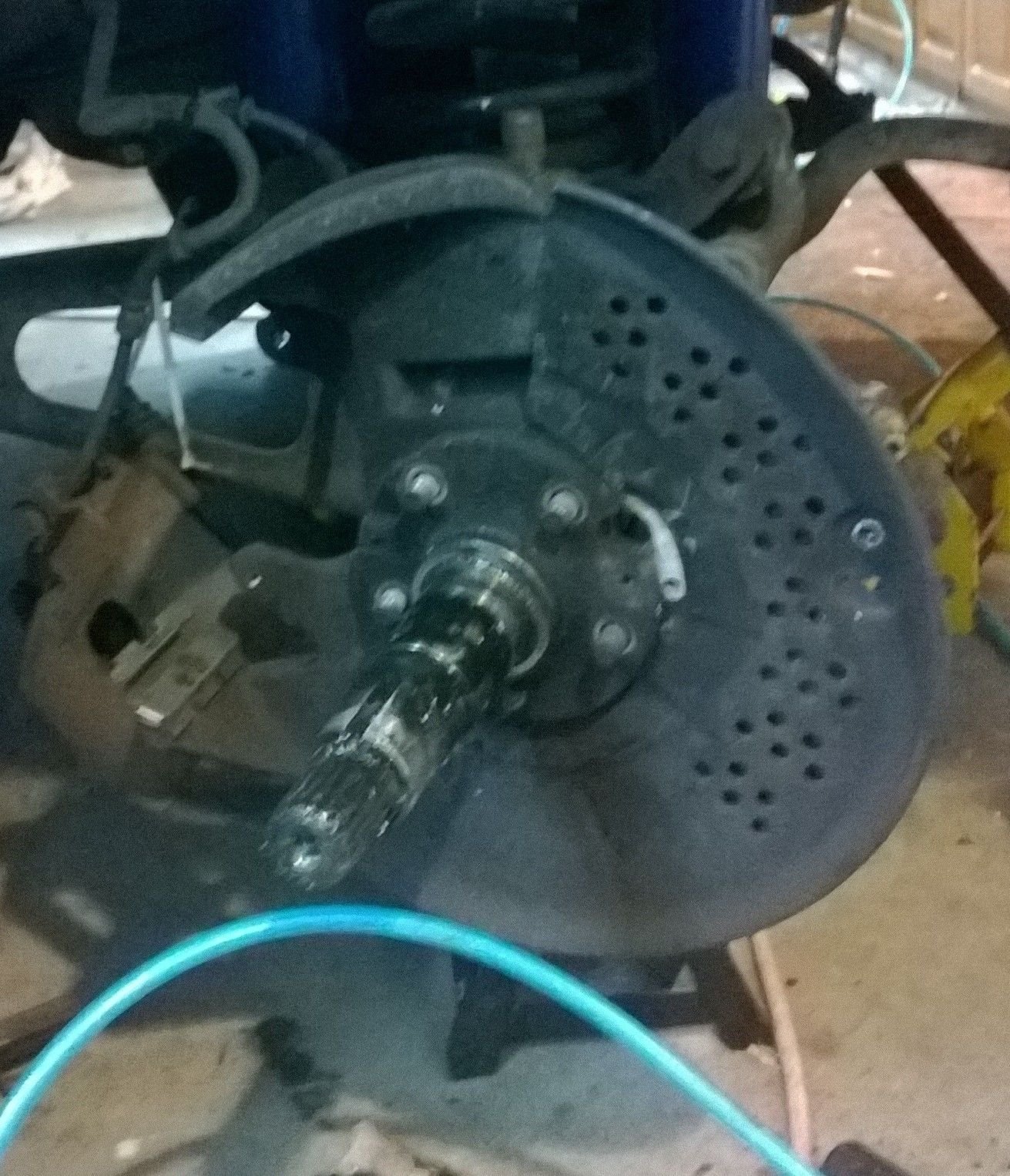

Bud if you want us to help you then you need to help us... If you can, provide us with details as to the year of the Bronco, stock or modified.
If you dont know what year take some pictures of the truck and upload it.
Also take some pictures of the spindle and knuckle at different angles.
Did you even unbolt the spindle? Stupid question but at this point I feel like someone needs to ask.
There's no other way to explain it but you need to hammer the chisel between the spindle to where it meets the knuckle.
And lastly stop getting testy with people, we are not your younger brother we are just trying to get information from you, which you are lacking to provide.
Here use this too, it may help

Make sure the ABS sensor shield thing is removed, as indicated in NewEnglander's picture (if your truck has 4 wheel ABS). Those things are a PITA and I never bother reinstalling them. The ABS still works fine without them.

You are coming here for help, so I advice in the future you refrain from using those wise comebacks, you'll get a lot more helpful responses that way. On to the subject at hand: You already have been told where to hit with the chisel, then you can also try a different approach, seeing the picture there shouldn't be anything holding the spindle, but you can re-check anyway, then try using a breaker bar to leverage, pushing the axle out. There is a Front End Rebuild link in my signature where I show how I pulled the axle out doing this with a tire bar, it could help you push the spindle out.
