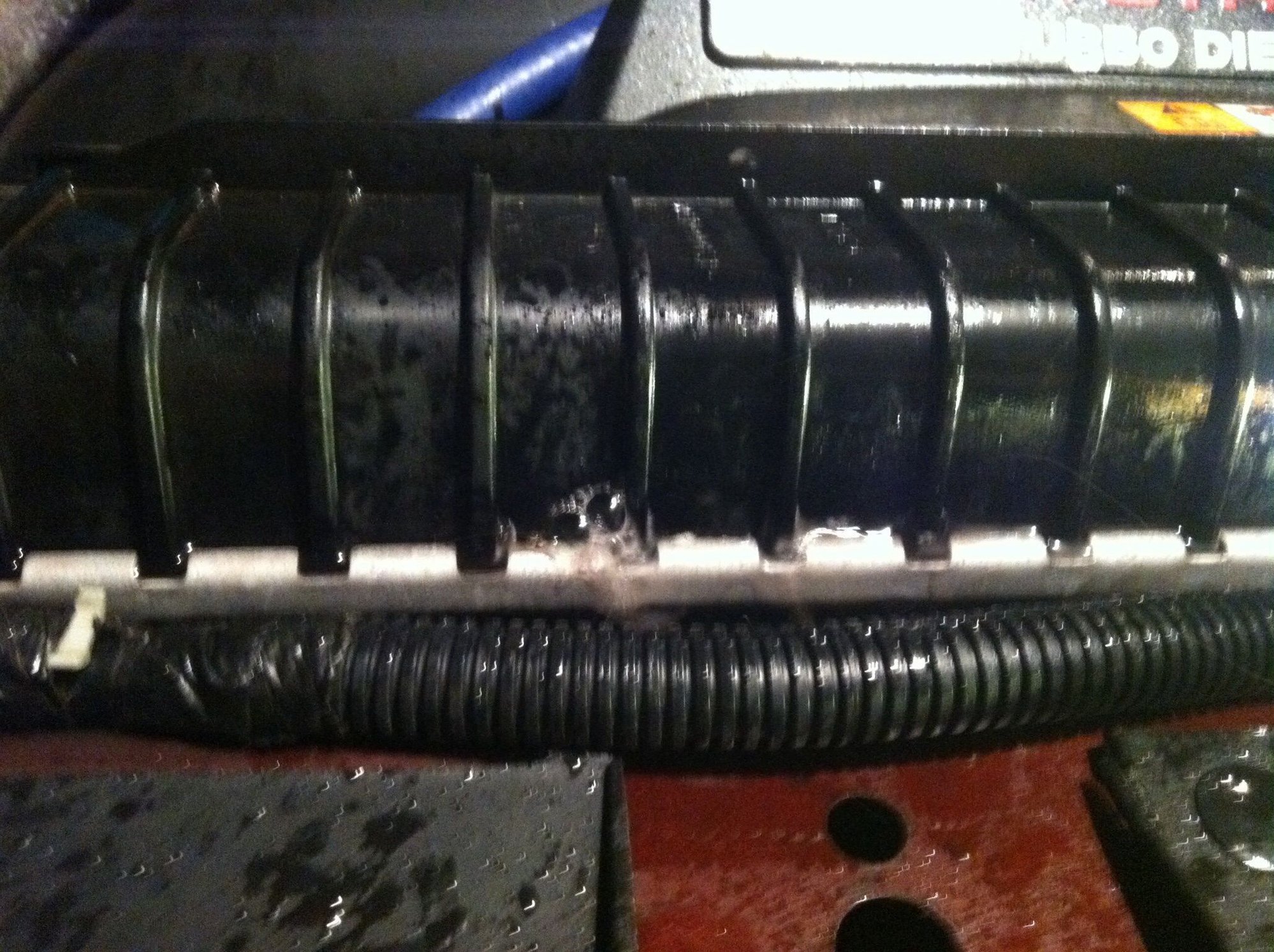

This is where mine cracked a couple months ago. It's bubbling because I had pumped it up with a pressure tester.
The thread is here: https://www.ford-trucks.com/forums/1...lant-leak.html

if radiator is cracked like the pic above, then it's best to get the mishimoto radiator, or an all-aluminum radiator. they don't have as much plastic around, and they hold up better. tats just my 2 cents.
