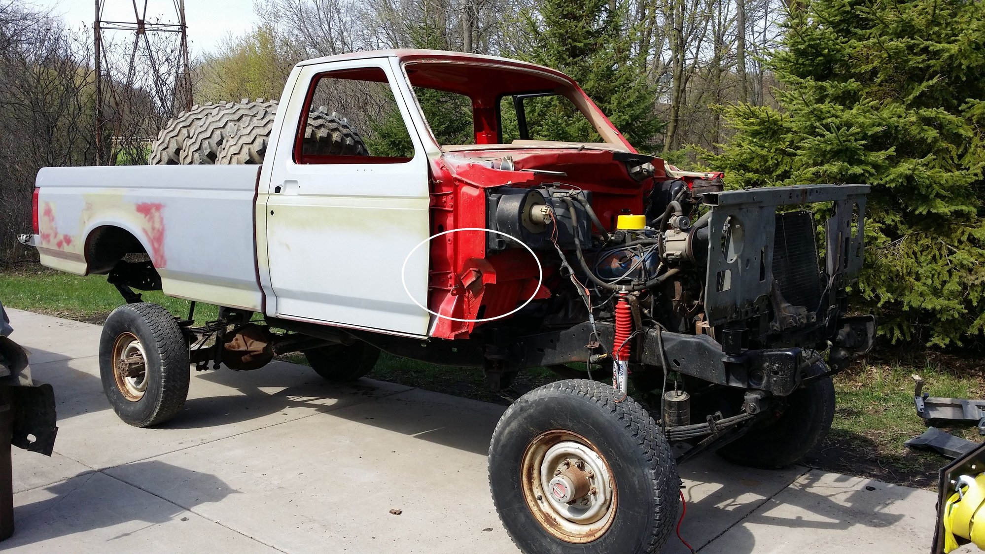

I used to have a 1982 F250, and I found out that that was the last year they fit those vent kick panels in these trucks. From what I could tell, the air came in from this rubber piece attached to the cab (i've highlighted it in white):
Do you know if the 83 and up trucks are able to use those vent kick panels?

To my knowledge, any 80+ truck without A/C has vented kick panels; factory-installed A/C included non-vented kick panels but the same body channels exist regardless.
