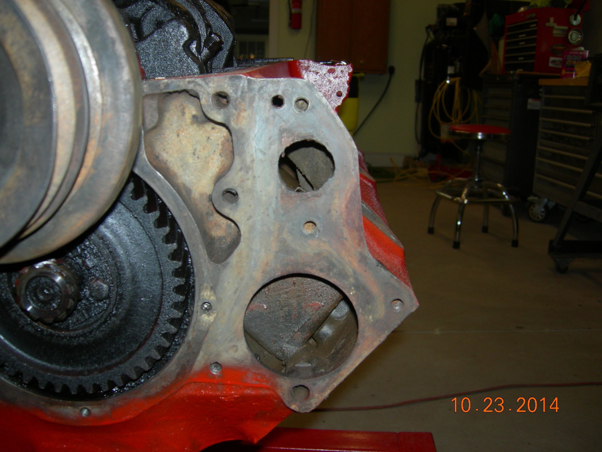

I'm not sure if the '47 block is the same but here is my '50.
FYI note that the engine is upside down on the engine stand right now. There is a drain **** mounted in the bottom of the radiator but there is also one in the bottom of the passenger side water pump. Note the holes in the top (which would be the bottom) in the bottom picture. The right one is the bolt hole but the left is a drain hole which on this vehicle was filled with RTV sealant. This prevented the block from draining properly so when on the engine stand I removed the water pump about a quart of coolant drained out.
