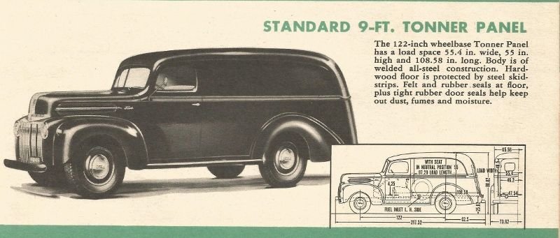

GB, here is a scan of a '46 Tonner brochure that I have. Looks like the tonner panel is just what you need.

I should have sent it like this the first time. Maybe you can see this one.

Third times the charm.

Now I see it! Thanks, Mark. But... I'm not sure what it has between the inner fender wells. I drove a '38 tonner pickup for ten years and it was way too narrow to set plywood on the floor. I think it was in '42 the rear axle and bed were widened. Looks like plywood would have to be tilted to get through the rear doors of the 9' panel, but that's ok if it sits flat between the wheel wells after it's in. Of course I'd still want one anyway. Maybe some that owns one will see this and grab a tape measure.

Between these here humps....

If I'm seeing the drawing correctly, it looks like the dotted line showing the inner fender lines up with the edge of the door opening. If that is the case it is still under 48". But it would still be a lot better hauling cabinets and plywood to the jobsite in a tonner panel than a GM van.
