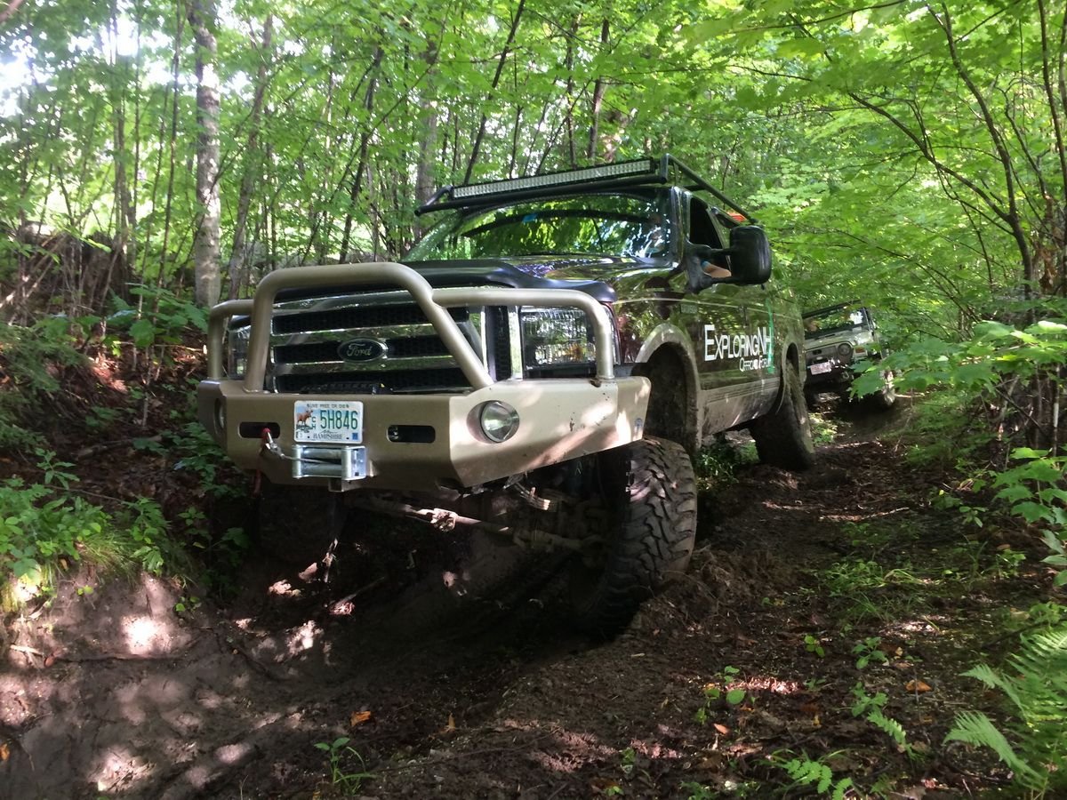

6" with 37s works fine for me offroad.

Nice set-up. I was going to start another thread but I'll just ask you. You're the 2nd Excursion I've seen with that bumper, what brand or who makes it, I can't quite make out the decal.

Isn't that a Buckstop bumper?
