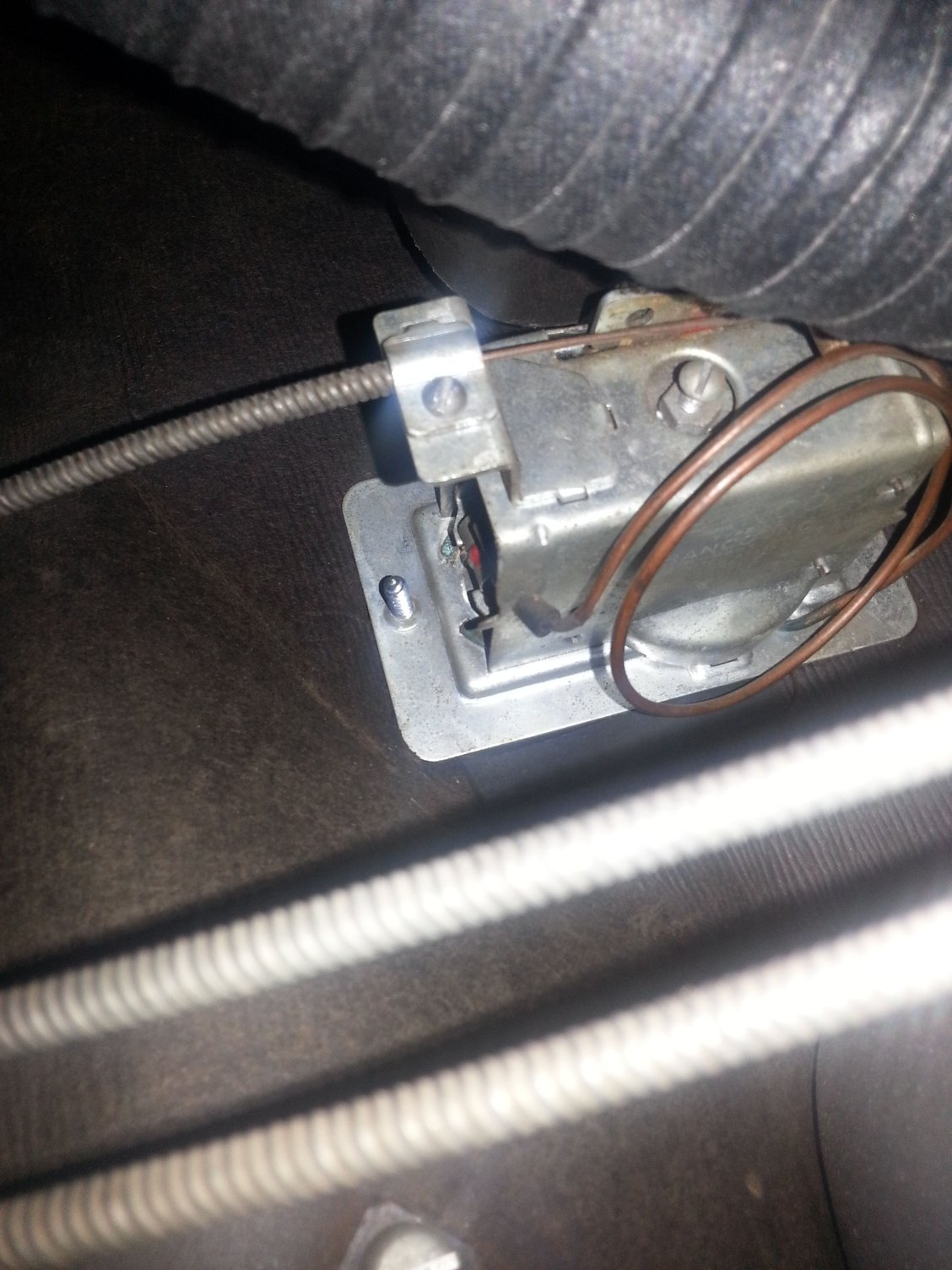

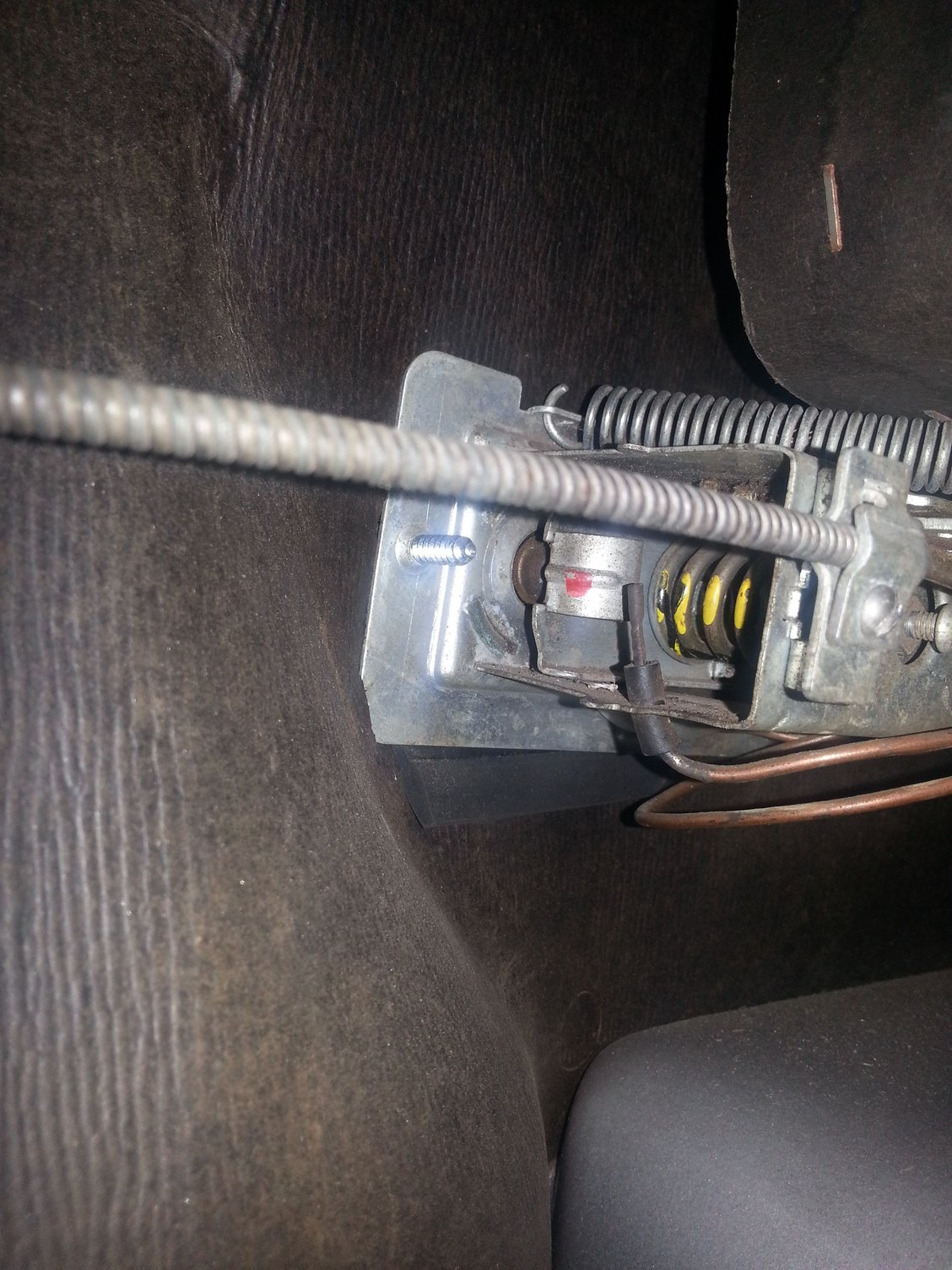

Old Oct 16, 2014 | 01:09 PM
FortyNiner's Avatar
FortyNiner
Joined: Jun 2011
Posts: 4,995
Likes: 422
From: u-rah-rah Wisconsin
Engine bay view:
Cab view:
