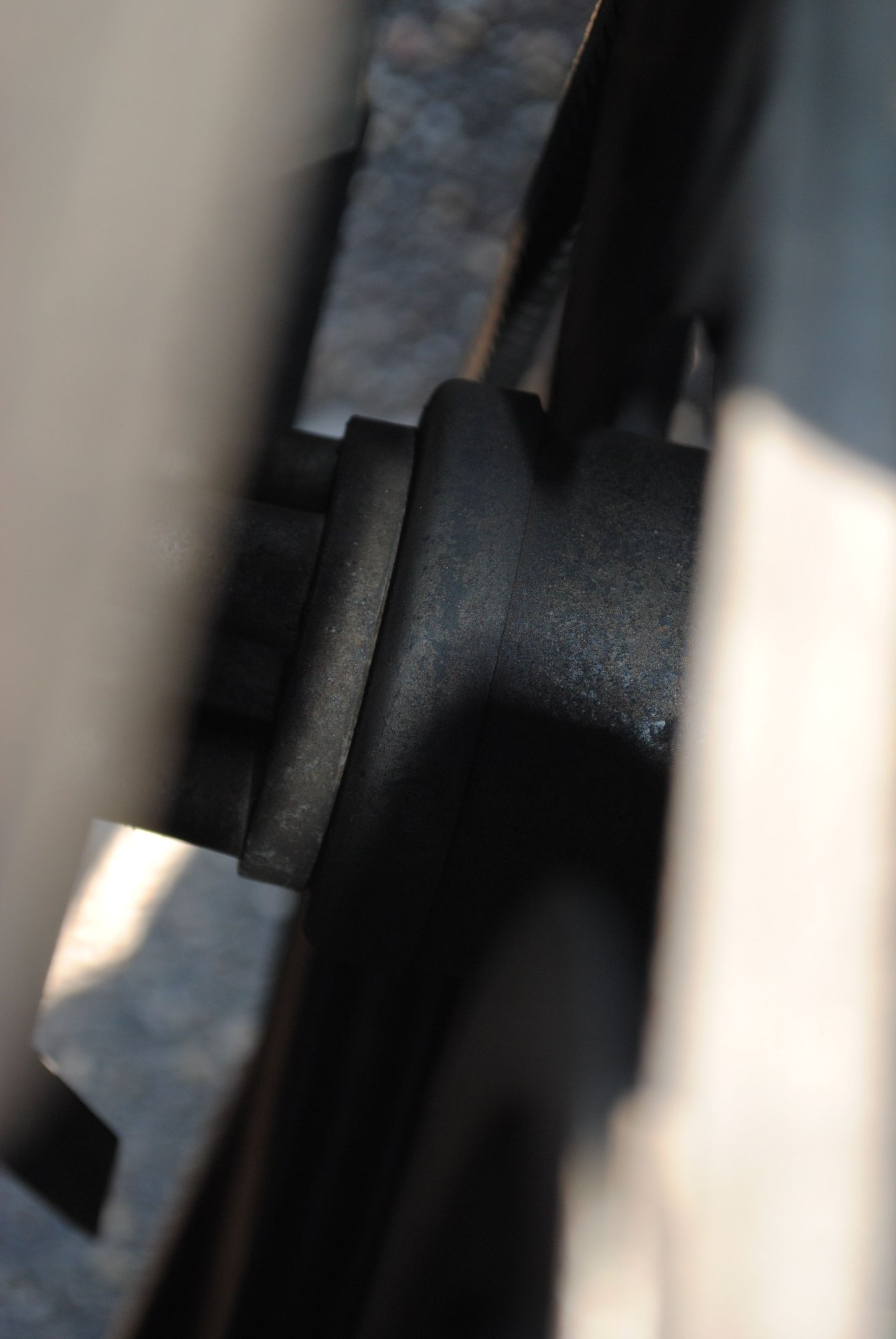

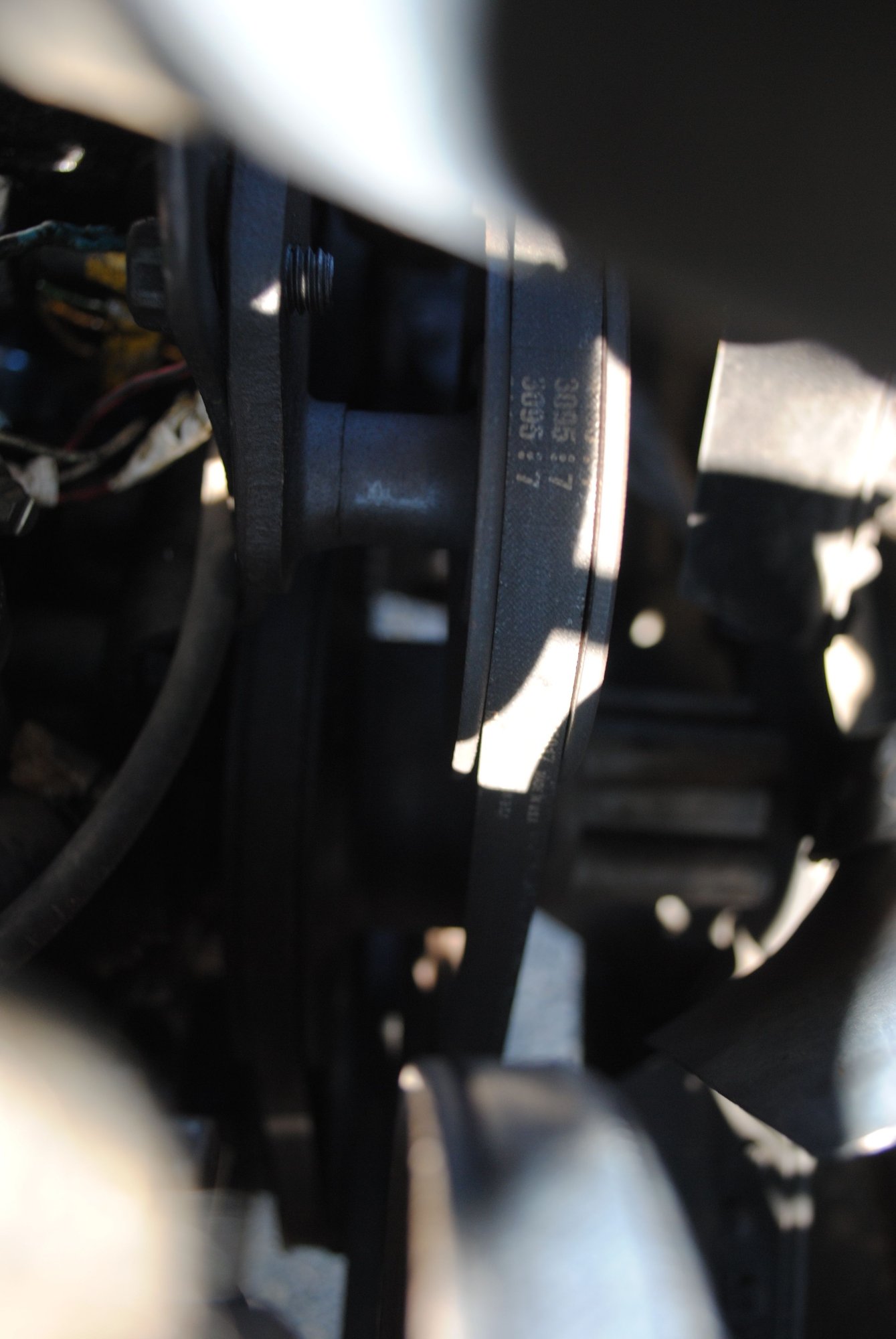

Well.... I don't believe I have a fan clutch... Heres the best picture I could get. dumb camera doesn't want to focus. The belt goes directly to the fan.

That's probably it. With your gears and with stock tires, you should be around 2K @45mph in top gear. My 80 302 with a fixed 5 blade fan IS fairly loud once you get above 2500-3K rpm. .Until the intake and exhaust roar drown it out I have the Granny 4 speed, 3:50 gears and 31" tires.

Yes, that's the source of your noise. A fan clutch would reduce that a lot.
