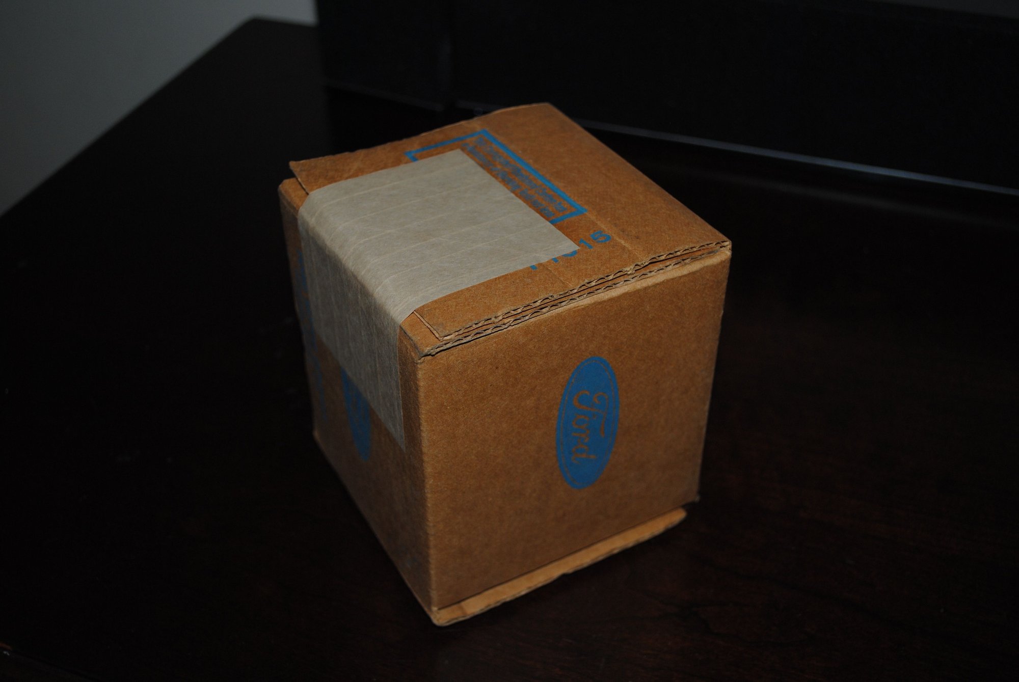

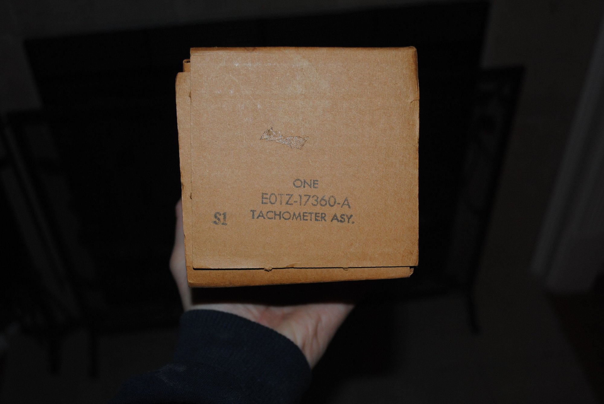

woohoo! I was lucky enough to find a NOS tachometer assembly on a website and only paid $88 bucks. I will let everyone know how it works out, should work no problem since it is the updated microchip version.

Good find!
