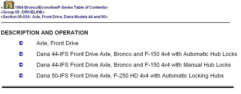

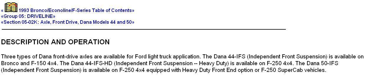

Originally Posted by Diesel_Brad
ALL 92-96(+HD 97 F250s) 4wd F250s had the Dana 50 TTB front axle. It is that simple. There is no room for discussion on this. The D44 HD got dropped from the line up in 92
Sorry to argue but.......
Clipped from my 1992 Ford Service Manual:
Clipped from my 1993 Ford Service Manual:
And it looks like 1994 was the first year with D50 only front axles:
Is my Ford Service Manual incorrect? Maybe, it would not be the first time.
I respect Brad's input but there are times anyone of us are not 100% correct. Been there, done that, still wear the dunce t-shirt from time to time.

yes, that is a typo. If you note. part of the text says the D44 was available in the F250. then part of it says it is Not
From 92+ the 44 only came in the bronco and 1/2 tons
