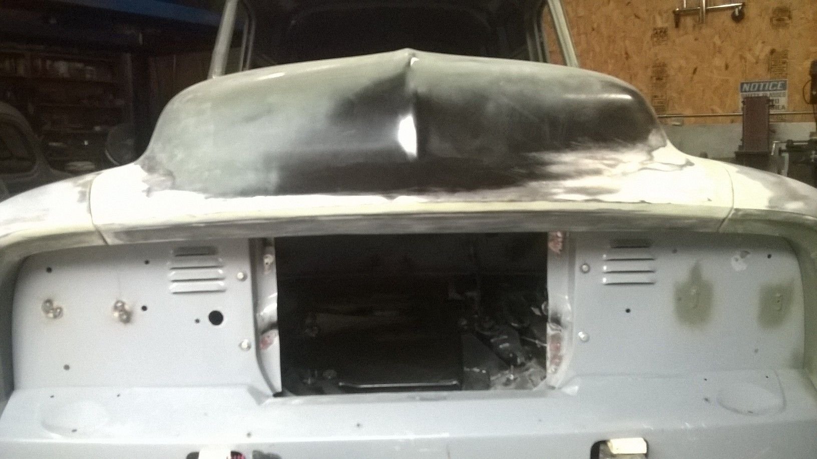

Here is is where I am at on the hood. If it was not for my son I think I would be canning this repop hood. I added these rods that were designed by John Bates. They really helped a lot on the passenger side.

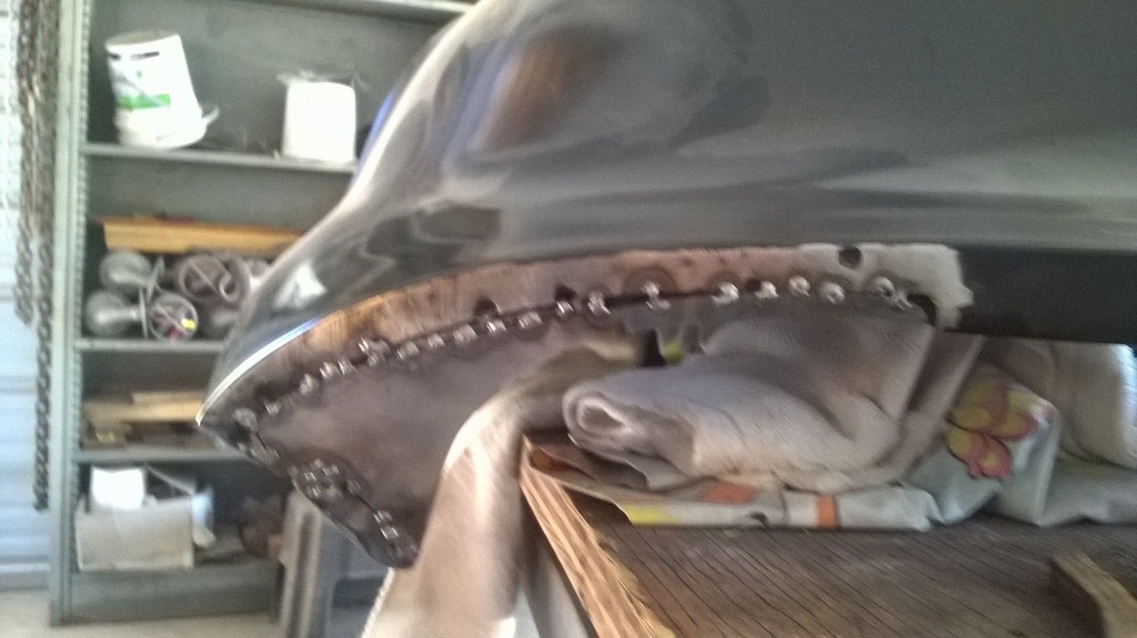

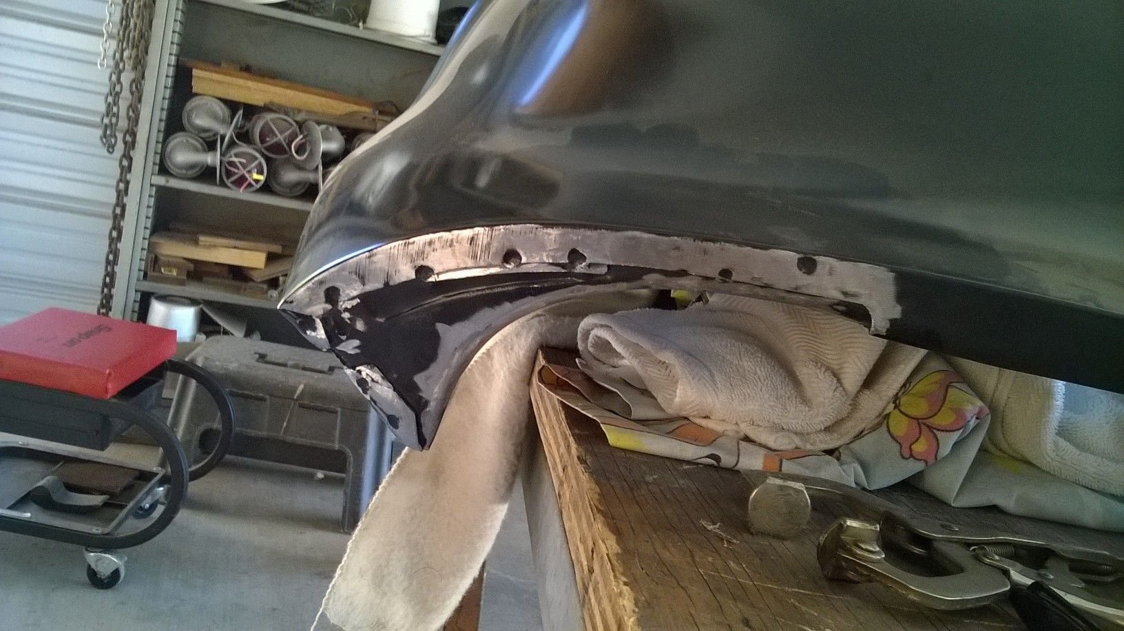

This area on the repop hood is in a great need of some work. If you are familiar with the repop parts these areas of spot welds are notorious for being sad, at least in my case. So I decided to try and alleviate this issues so it don't look like a cave between the fender and hood. I also did the area on the fenders they were worse.
Fitting the patch
Welding patch pc to help eliminate so much filler
One coat of filler and epoxy primer

This area had major issues I could stick my finger in the gaps between the spot welds. Made a patch similar to the hood welded, filler and a coat of e-primer
Shows the area where the fender meets the lower valance, really was bad in that area. This area I welded and polished than put a coat of e-primer on. Going around on the fender where they spot weld the fender to the inner support I filled with filler and a coat of e-primer.

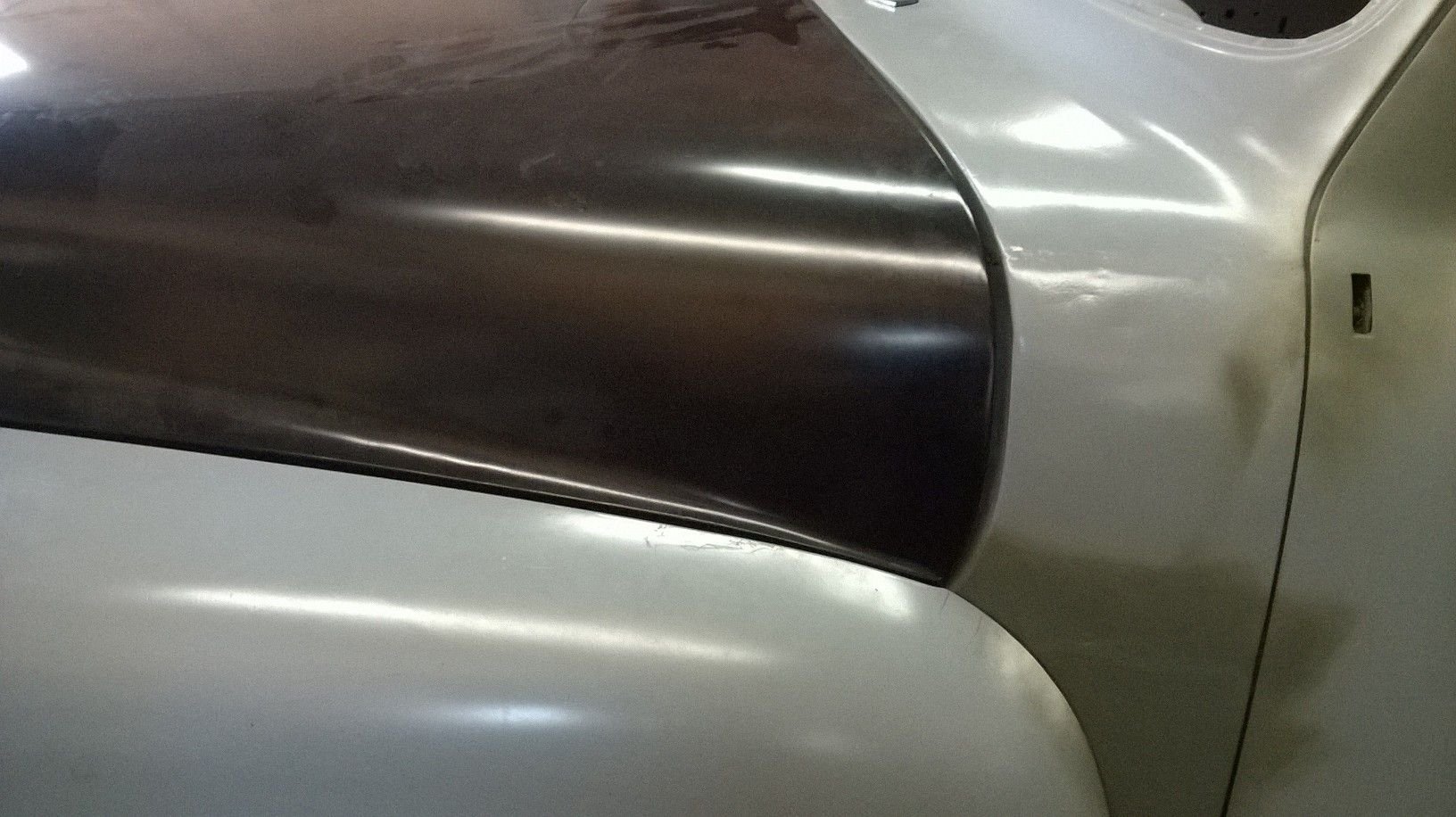

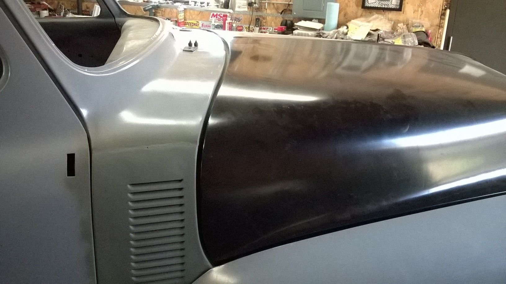

Driver side is a shade better. Still more tweaking needs to be done.
Gap at cowl is respectable not sure if I will go after it. The hood tilts forward so don't need such a large gap. Where the hood parallels the fender, the hood is still up a touch still thinking about the fix.

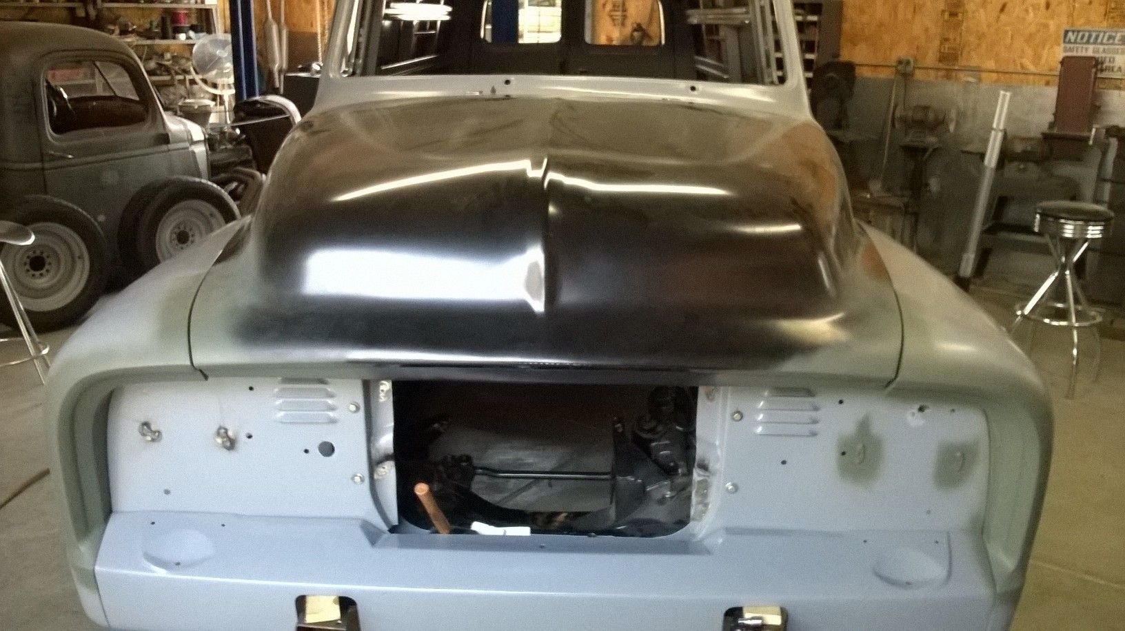

The way it looked on 9/13/15
Nov 2 2015
I ordered the front hood under section from Mid-Fifty, cut the section that holds the hood pin off and welded it to the existing front section. Basicly I just skinned the nose. This allowed me to align the new nose to the fenders and all lines match up.
