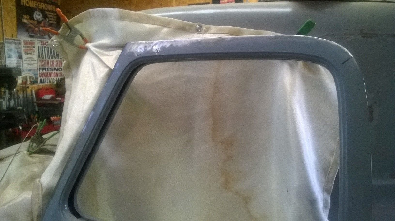

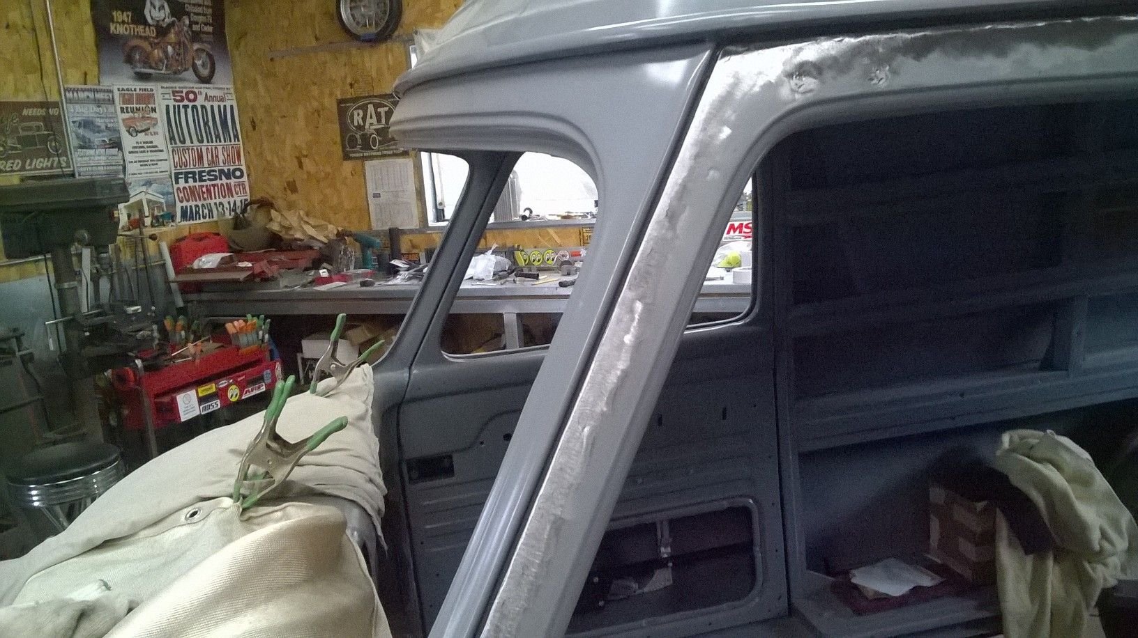

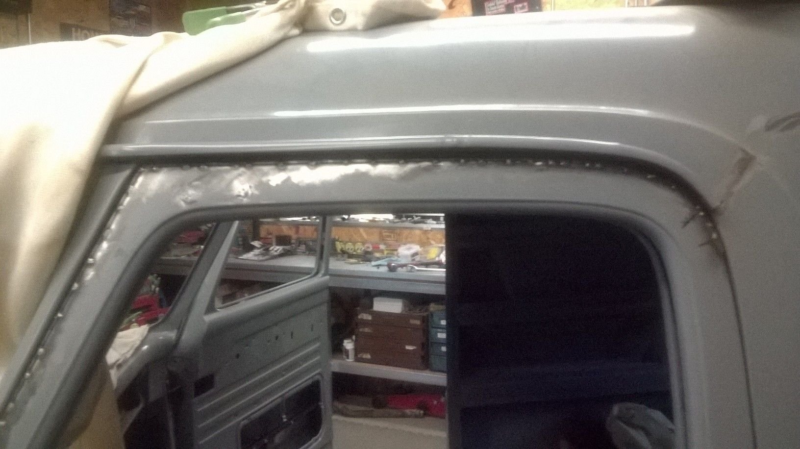

Been looking at the gap on the drivers door and finally decided I could not live with the 1/4 gap, after many adjustments I am going to weld on an 1/8 rod around the door in the areas needed, top and front pillar area.
1/8 inch rod tacked in place
More
Present gap. Will finish weld and polish. Than will post finished.
I had the whole panel powder coated so have to remove the powder. Welds don't like that stuff. I am quite impressed how the powder feathers and when I block sanded it, it smothed out real nice. So so far all is good in that area.

Got the door done, minus a little filler and prime. Took quite awhile to weld than polish. I got the door gap within reason in comparison to the passenger door. Have posted passenger door pics for comparison.
Passenger gap for comparison
Another of the driver side that was a big problem
Passenger side for comparison. I believe I am within a 16th-32nd.
Never done this before an old time hot rodder told me about this method and I am sure you all have known about it for quite awhile.
These doors were not original to this panel. I had bought a couple parts trucks to get all the final parts. In todays times these parts trucks I bought were keepers, if I only had vision.
