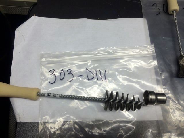

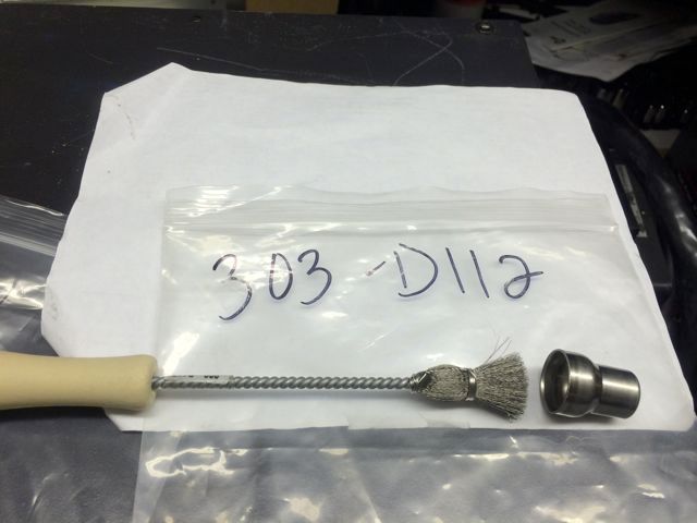

One thing that is nice to have is a set of bore brushes
or at lease something to do a good job of cleaning the
bores. Also a digital camera to check to see how
clean you got them.
Brush 303-D112
Brush 303-D111
Sean
