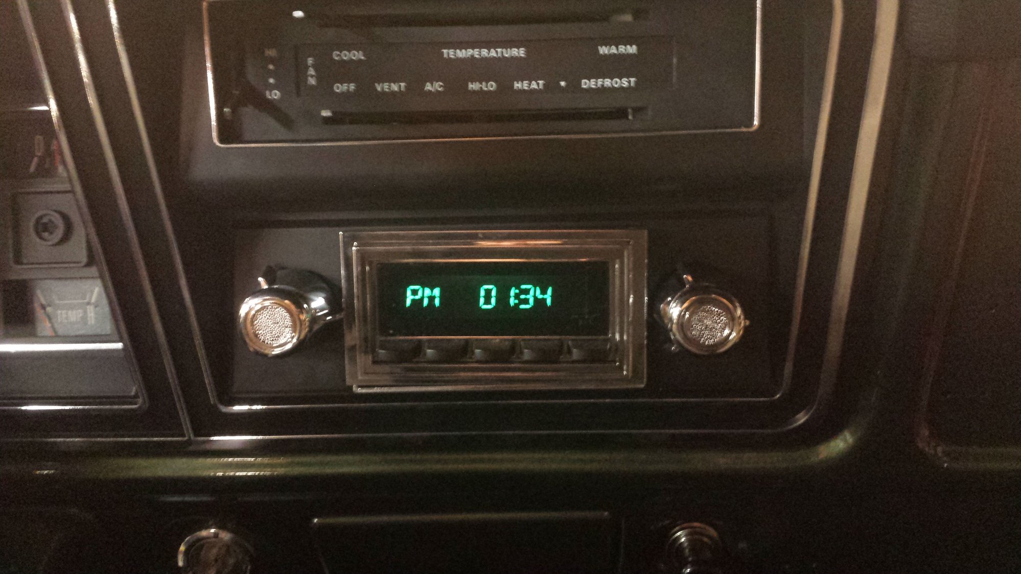

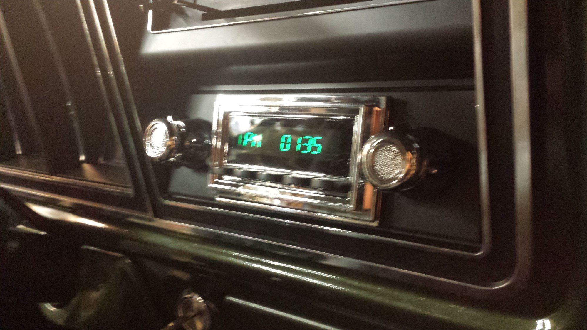

I went with the Retrosound Model 2 as I didn't want to hack the dash at all after all the work I have put into it.
Retrosound Model Two (Chrome/Black) Digital media receiver for classic cars at Crutchfield.com
Has all the modern amenities (usb ports, bluetooth, pre-amp outputs, etc.) and looks very close to the Ford OEM deck for a modern solution.
Not cheap though, but if you want to completely avoid hacking the dash this is a good way to go.
I still need some fine adjustment, but the mounting system is adjustable in all directions so should not be an issue.
