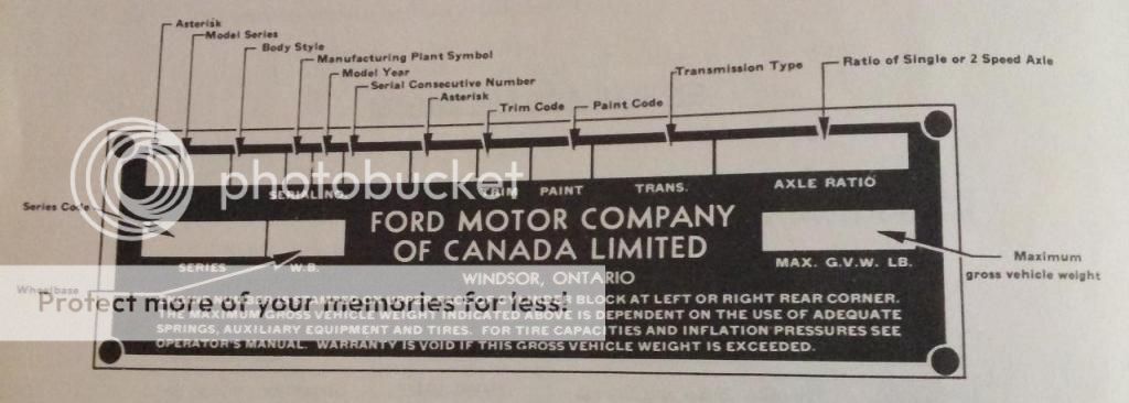

1953-56
Transmission Types
Code Type
3 STD - 3 Speed – standard
3 OD - 3 Speed – overdrive
AUTO - Automatic
3 HD - 3 Speed – heavy duty
4 STD - 4 Speed – standard
5 LD - 5 Speed – light duty
5 MD - 5 Speed – medium duty
5 HD - 5 Speed – heavy duty
5 DD - 5 Speed – direct
5 OD - 5 Speed – overdrive
Trim
Code Description
12 - Tan Genuine Leather
13 - Two-Tone Vinyl (DeLuxe)
14 - Red Vinyl (Standard)
AGA - 1955 - Gray Woven Plastic
AGA - 1956 – Red Vinyl & Gray Plaid Woven Plastic
BGA - 1955 – Gray Vinyl and Red Woven Plastic
BGA - 1956 – Red Vinyl & Black & White Woven Plastic
CGA - 1955 – Gray Vinyl and Green Woven Plastic
CGA - 1956 – Tan Vinyl & Black & White Woven Plastic
Maximum Gross Vehicle Weight – The maximum gross vehicle weight is recorded in this space.
Manufacturing Plant Symbol
H - Windsor
K - Oakville
Model Year
Q - 1953
R - 1954
S - 1955
T - 1956
Rear Axle – The actual ratio of the rear axle is put in this place. Both ratios will be used where two-speed axles are involved.
Body Style
81A - Closed Cab Standard
81B - Closed Cab DeLuxe
82 - Panel Delivery
83 - Pick-up and Express
84 - Open Drive Away
85 - Closed Drive Away
