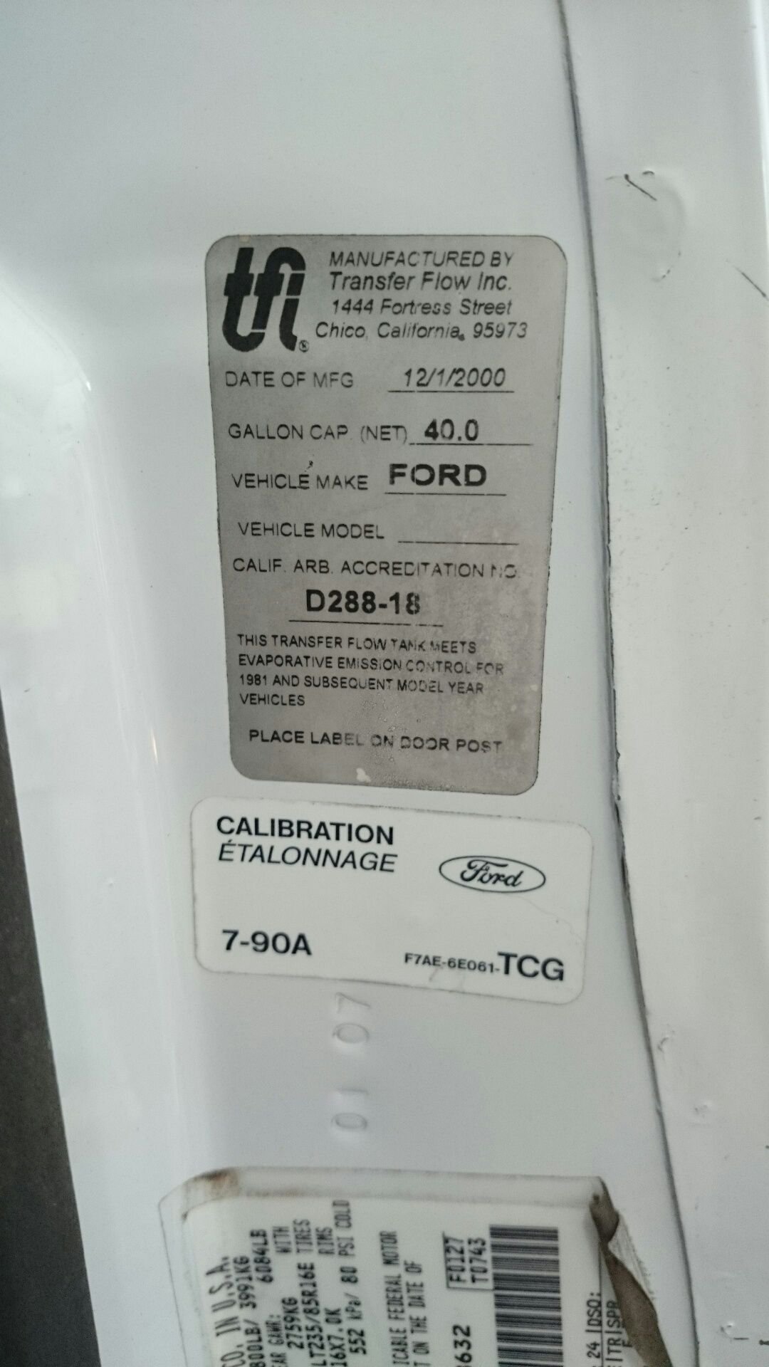

Tag about the fuel tank
Finally got time to work on the fuel selector, switch is good, fuses are good, found out that this truck has a after market fuel tank the blocks the selector valve. see

40 gallons? Is that a tank in the bed, or do you actually have a 40-gallon rear tank in the frame? I thought T-Flow only made in-bed tanks.

It a tank that under the truck, just forward of the rear to just under the drive seat.
