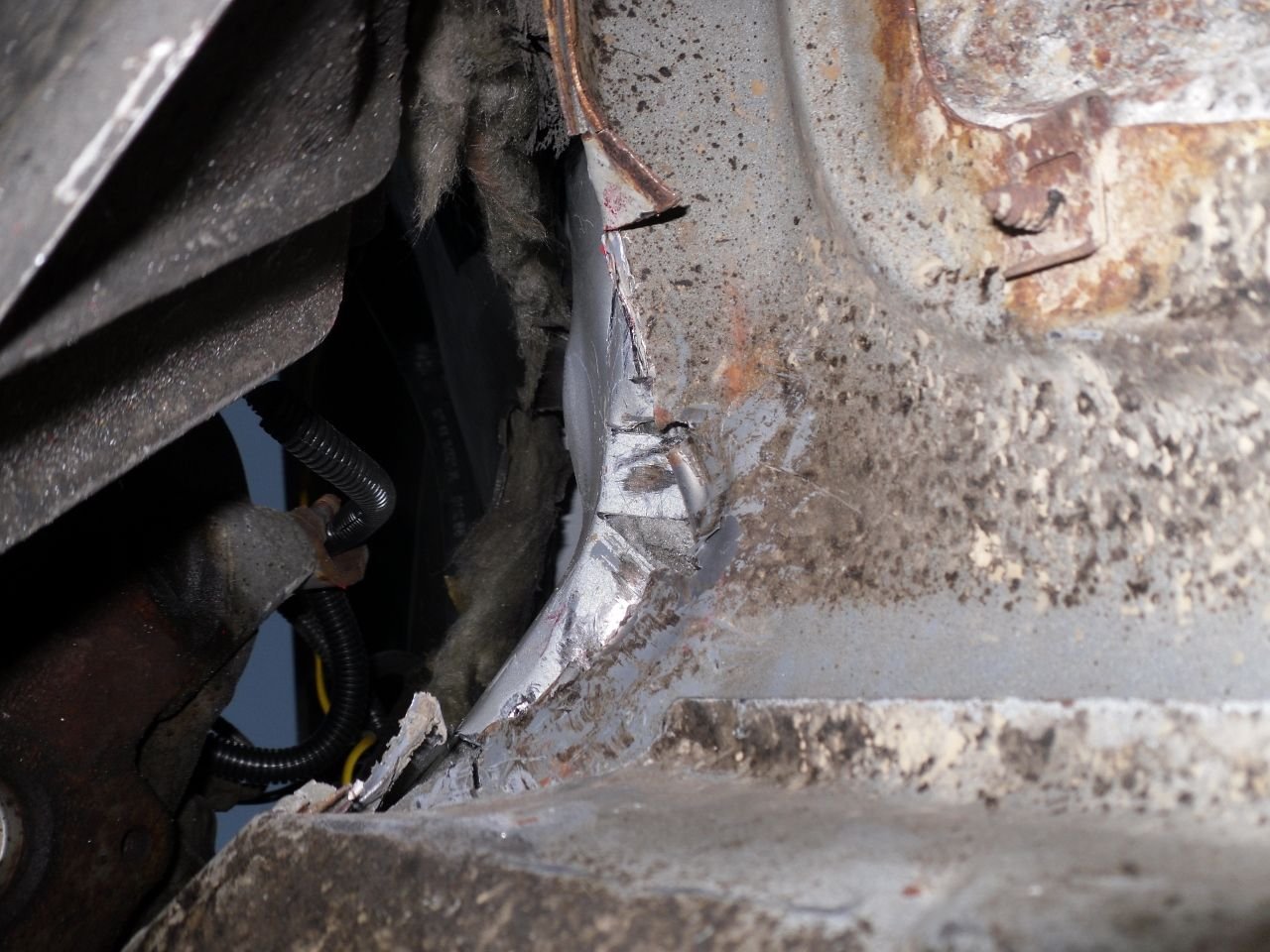

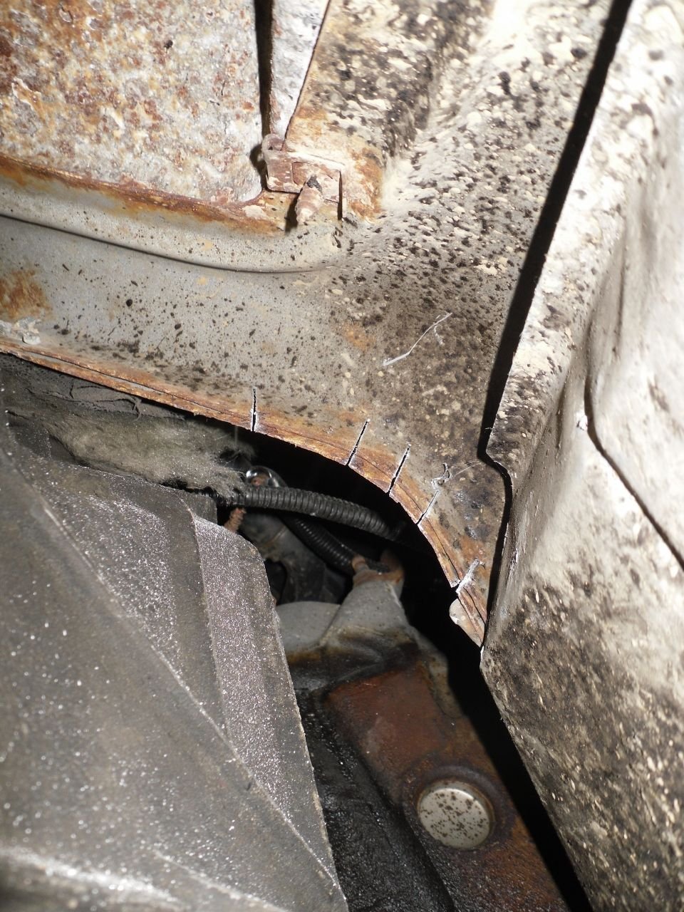

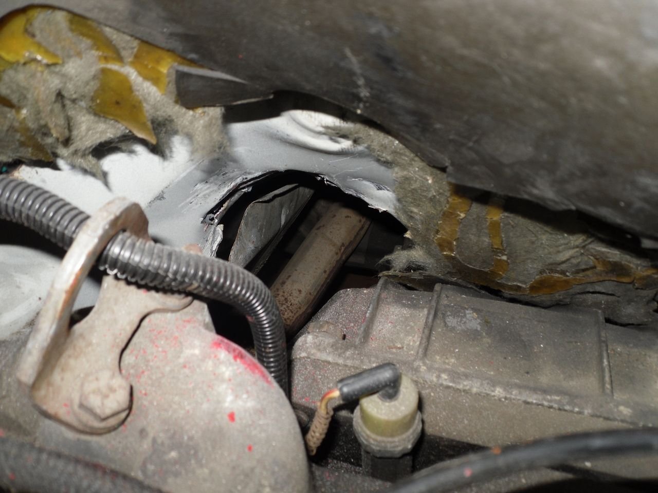

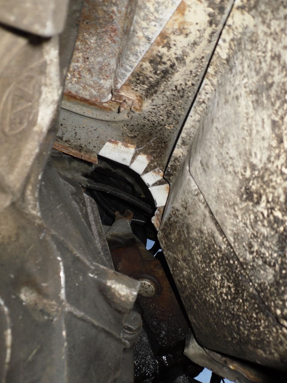

I did manage to get a lot more space out of the firewall beyond just folding the seam. Here is how. You can't crush the folded seam area farther because the it is too strong. Pushing with a jack just lifts the truck. I cut the folded seam right off which splits the firewall from the cab floor making it much weaker. Then i cut a number of slits around the curve. Then with a jack the area crushes like butter. Bend the cab floor up from below with the jack, and bend the firewall in from above with a prybar off the head. I got the 3" pipe in now but i gotta do some more to make better clearance. I will post pics soon.

I finally got it all worked out. BRUTE FORCE METHOD. I don't really give a crap about my cab so I just hacked it out. Attached are some pics. I have clearance now for a 3" pipe with about 1/2" extra space (1/4" per side).

slotted out
seam bent over.
not enough for 3" pipe.
so i cut the seam right out and crushed the space back more. as per above post.
from above.
