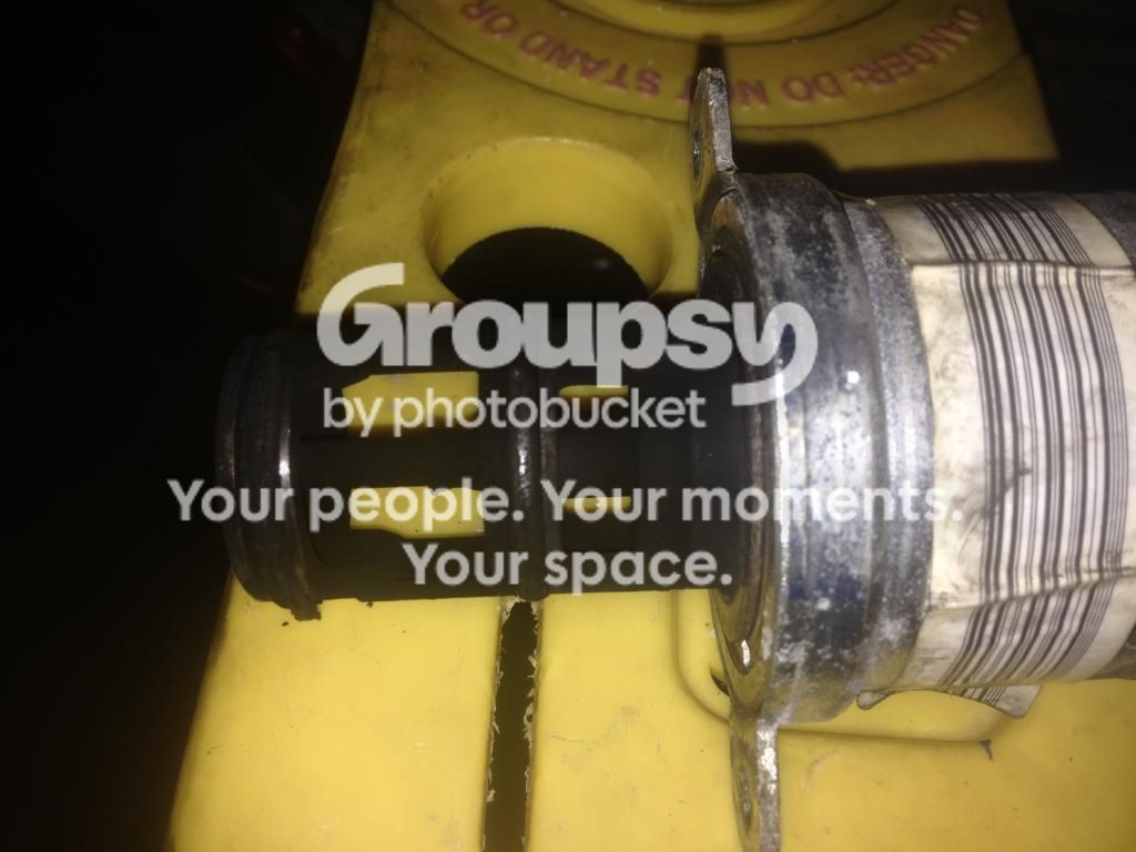

Update - Pulled the EGR valve, here is a picture of it:
WHat do you guys think? I didn't think it looked too bad or bad enough to be the cause of the problem. I went ahead and cleaned it anyway. Put it back in and took the truck for a drive. To my pleasant surprise, its back to its normal self. Boost is great and obviously the truck has plenty of power again. EGT's are running normal again. The CEL cleared and I reset the DTC and they have not returned.
I am going to keep driving the truck and monitor the MAF and VGT values and see if the problem returns. I just find it hard to believe that the EGR was to dirty based on others that I have seen. Maybe unplugging and replugging it reset the valve or something along those line.
To answer the VGT question, I didn't start monitoring that until after I cleaned the EGR valve but the values are changing.
What do you guys think? Did I find the problem or is there something else I should keep looking for. Thanks.
Does not look bad at all. But what ever you did would seem to have
fixed the problem.
Keep the rubber side down.
Sean
