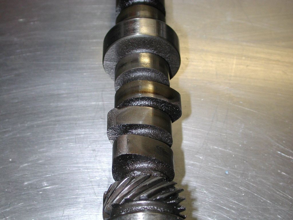

Here are a couple of pics of the cam I took out of a 351W. If you look at the cam from the front, the first four lobes point roughly at:
  1. 11:00
  2. 10:00
  3. 3:00
  4. 6:00
I would think that a cam that caused an engine to rotate in the opposite direction would have the lobes staggered differently. In addition, the gear teeth for the distributor might go the opposite direction, although they could stay the same. However, they usually like to change them for rotation.

Thanks for the pic
