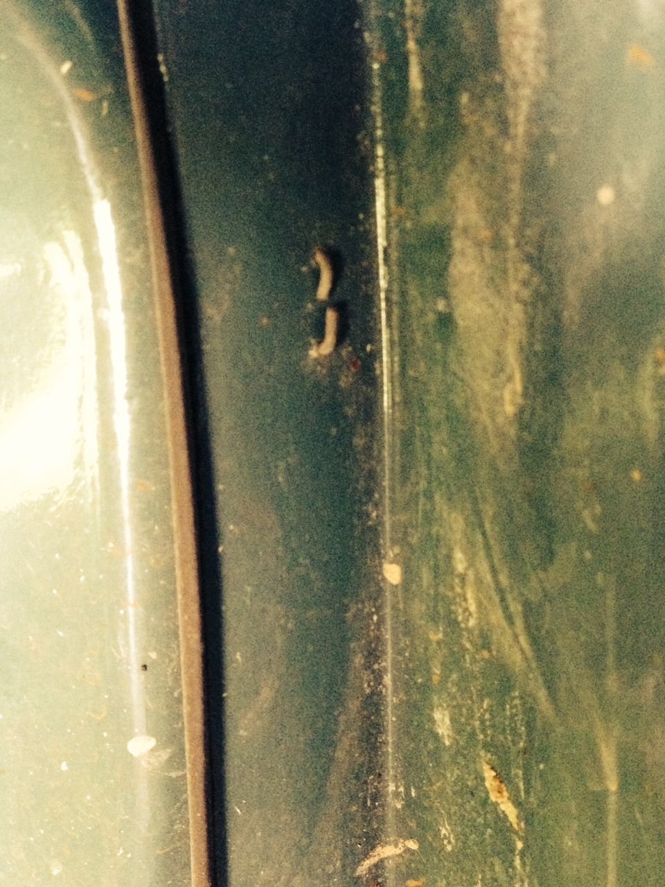

These foamy rubber seals were originally stappled to the fenders. when I put mine on I formed staples from galvenized wire.. When I look under the fenders I can see the clinched ends of the staples. I think I used electric fence wire which I had on hand. You should be able to see the staple holes in the fender.
Also the flat part of the seal lays with the fender not the cab. So it appears like an extension of the fender and they but up against the cab. Hope that makes sense. Let me know if you want a picture or two. Patrick

I took 3 pics. The seal is sorta H shaped and the longest leg goes on top of the outside of the fender. Also, you'll want to use a thick fabric that comes in a roll between the fender and inner fender and also between the front of the fender and grill and body parts above and bellow the grill. Sorry, I am having trouble posting the pictures and I can't remember the name of the fabric maybe welting. It is about 1/16th inch thick as I remember. Using home made staples in the original holes, you will need to fasten the seal before installing the fender. The seal goes all the way to the bottom of the fender and gets clamped between fender and small extension of fender below the cab and disappears below the running board. If I had your email, I could send you the 3 pictures. Patrick

Pics of fender seal
view under fender, see staple that attaches seal to rear of fender.
view straight up under rear edge of fender. See seal end with longer leg on outer surface of fender. The seal is U shape just to left center of picture.<br/>
Fender seal at rear of fender<br/>
