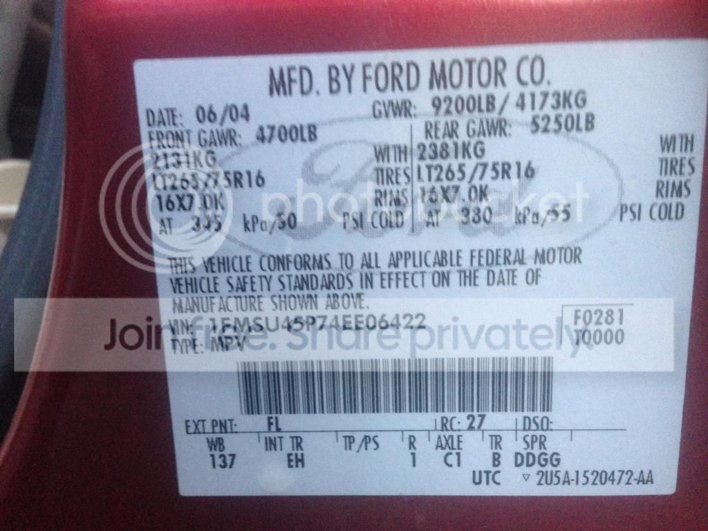

Lastly, I read that you can determine what springs you have by the door sticker. Can anyone help me determine that from this door jam label? I am assuming its the stock springs based on the stance.

So by doing some research I determined that I use the 2nd and 4th digits in the spring code. The 2nd digit is the Front spring and the 4 digit is the Rear Springs. So I guess I have "D" rated front and "G" rated rear. Here is a link to the website that helped to explain it for me.
http://www.sdtrucksprings.com/ford-spring-code-listings

Here is a handy chart if checking Ford springs.
The following only applies to 4X4 EXs, the 2X4 rigs have coil springs up front. All EXs came from Ford with G code rear springs, the V-8 EXs all came with B (front B code is much different than rear B code, confused yet?) 4100lb, all V-10 EXs came with C code fronts at 4300lb and all PSD EXs had D codes at 4700lbs.
All the other codes discussed come from SuperDuty trucks (they came with springs that don't suck from Ford.)
Spring........Capacity.....Rate lbs/".....Max travel.....V-10 change.....PSD change
B (V-8)......4100lbs.......330 lb/".........5.02"...........-0.25".............-0.66"
C (V-10)....4300lbs.......350 lb/".........5.01".............0.00"............-0.37"
D (PSD).....4700lbs.......380 lb/".........5.14"...........+0.33".............0 .00"
S codes.....4000lbs.......370 lb/".........4.34"...........+1.22"............+0 .88"
T codes.....4400lbs.......390 lb/".........4.63"...........+1.42"............+1 .11"
U codes.....4800lbs.......410 lb/".........4.89"...........+1.60"............+1 .32"
V codes.....5200lbs.......430 lb/".........5.13"...........+1.77'............+1 .50"
W codes....5600lbs.......450 lb/".........5.34"...........+2.77'............+2 .52"
X codes.....6000lbs.......470 lb/".........5.54"...........+2.90"...........+2. 68"
W codes are from F-450s and X codes are from F-550s and other SD trucks with snow plow prep. The above spring info has been gathered from posts here on FTE by "monsta" and "bruce1954".
Make sure your EX has load range E tires on it before towing that large (nice) trailer and be sure to run the trailer tires (if type "ST") at max pressure as listed on their sidewalls.
