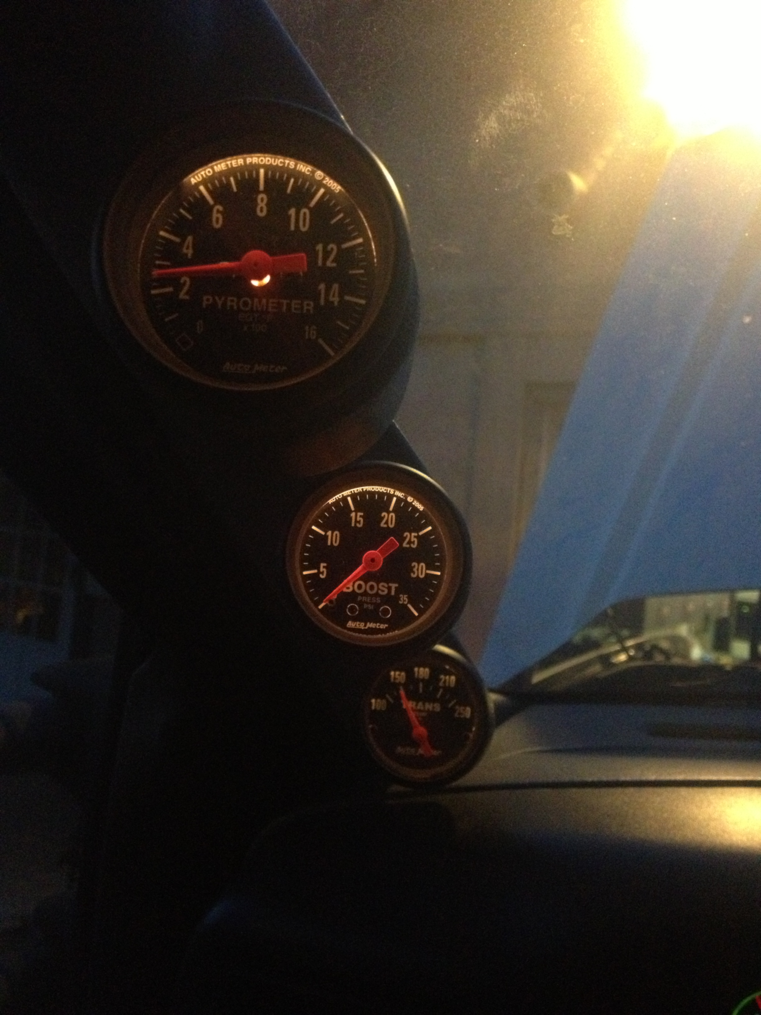

ok guys got my gauges installed finally. but my boost needle doesn't move. hooked it up how this picture says to do it. any help will be greatly appreciated.
Old Oct 17, 2014 | 05:08 PM
  #28
kx125str99's Avatar
kx125str99
Joined: Aug 2010
Posts: 122
From: santa clarita
here is a pic of my gauges

Boost gauge won't show any pressure until you drive it. If you tee'd it like the picture and don't have any kinks in the line from the MAP sensor to the pillar then you should be good to go.
Old Oct 17, 2014 | 07:45 PM
  #30
kx125str99's Avatar
kx125str99
Joined: Aug 2010
Posts: 122
From: santa clarita
after reading your post I went and drove truck. it works haha. thanks I was worried
