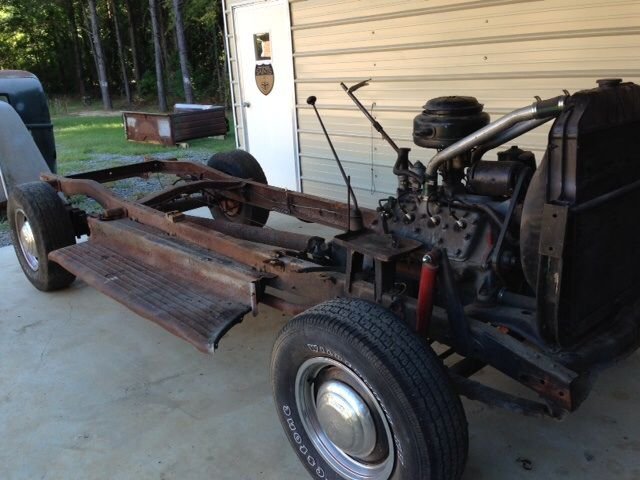

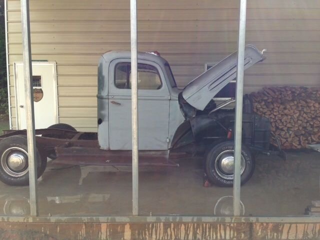

I've got my hands on what I believe is a 45 1/2 Ton. The title states a 45 and VIN differs slightly from the numbers I've located on the frame this morning. My guess is the previous owners did little to clean up the stamping. The number I have is 99C639282, between stars. Also there is a 59 on the bell housing, which I believe indicates a 45 V8? I've already started tearing it down, planning a full restoration. I know I have my hands full, but it's a journey and it's become a family project with my wife and I. I'm thankful I found this website and group, so much info, tips, ideas!
Chicken Truck finds a new home. I'm not big on the running lights on the cab. We'll correct that.
First day tear down, got a late start but I think we did ok.
The wife thought I was a genius, but I fessed up, youtube
The 99C is hard to distinguish, but it's there.

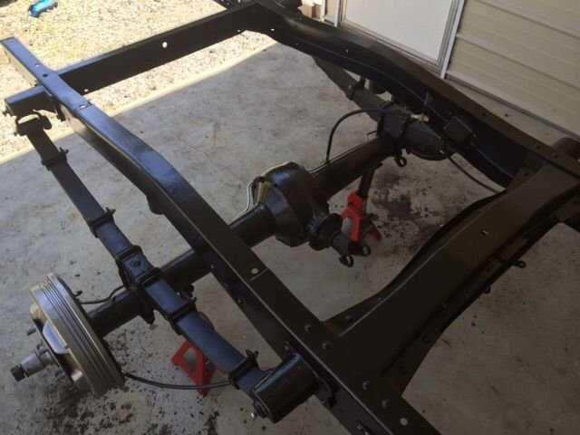

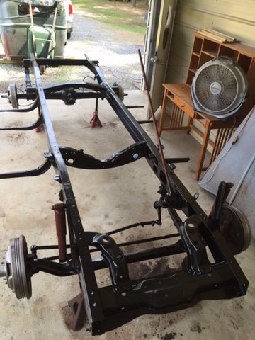

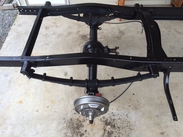

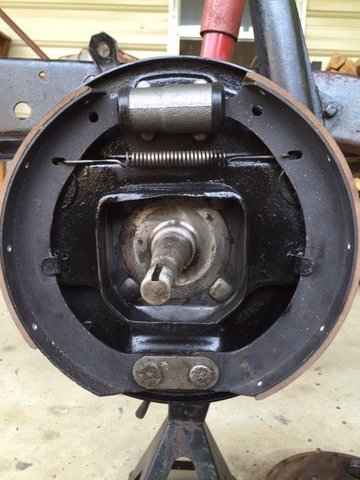

Well it's been a while since my first posts. What with the Holidays, surgery, new grandbaby, and work time hasn't been on my side. But with the better weather this spring and early summer we've managed to fit in some time to labor on the '45. Got her down to the chassis, cleaned, primer, paint. New rear springs, pins, bushings, swing arms. Axle done, wheel bearings done. Brakes done, master cylinder done, brake lines done. The flattie torn down and looking pretty good, parts being ordered this week.
