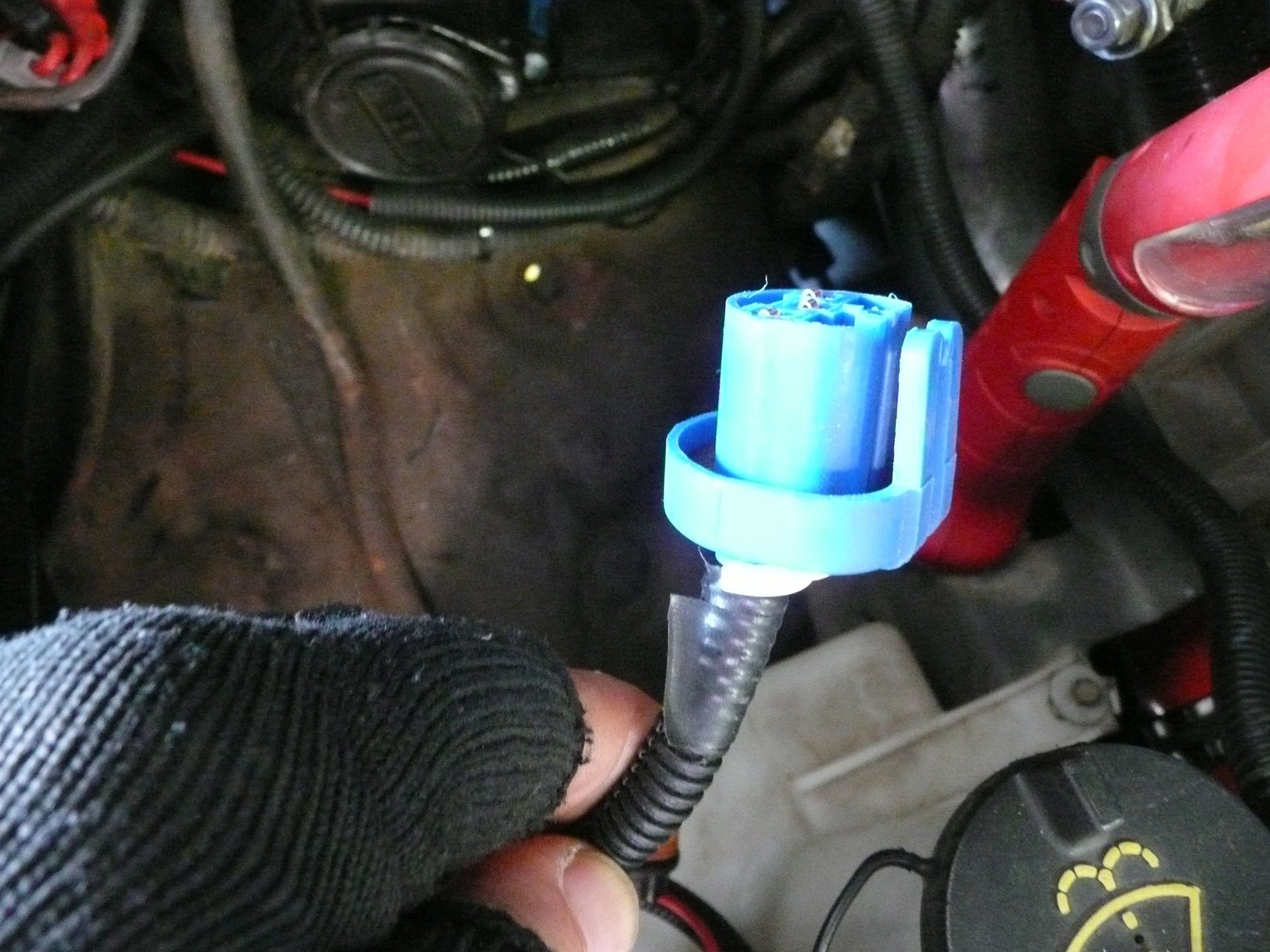

I've got two light plugs on the truck the blue one has been taped up and tucked away the one with the globe is the HID but has to go as the light pattern is crap , my question is what is that blue light plug ? what is it supposed to fit?
This is the blue plug does anyone know what it fits , or have you see this type of connection.

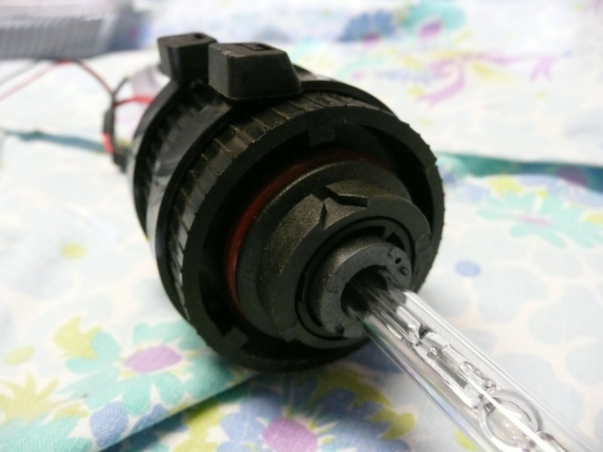

This is the Hi /Lo Hid globe

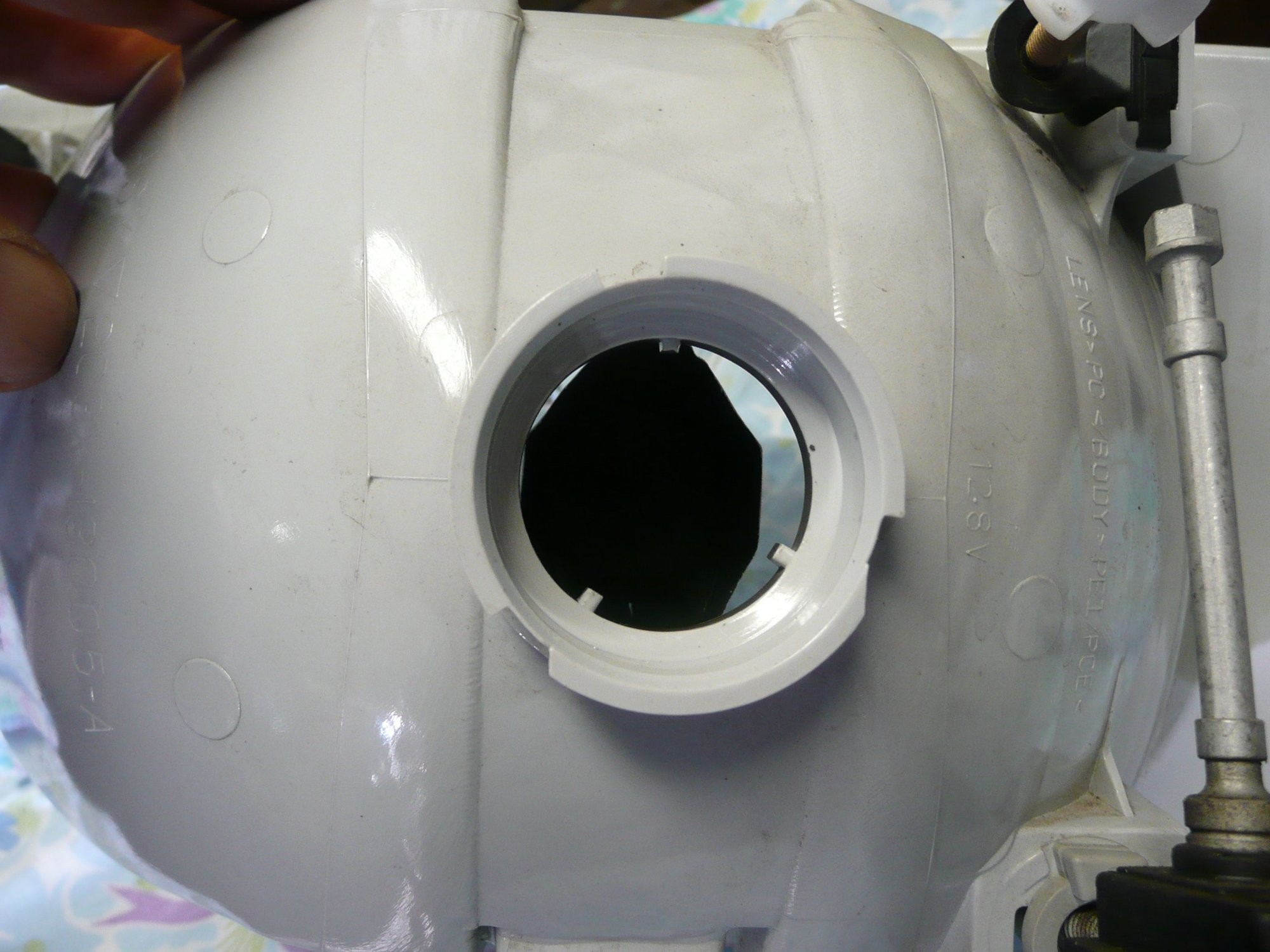

This is the back of the headlight housing , takes a 9007 globe
The back of the Hid globe , i modified it to fit the new type of light housing .<br/>

The blue plug looks to be the one set up for the halogen 9007 (H13) bulb.
The 9007 has an 'implied' LHD low beam cutoff which is achieved by the orientation of the bulb - low beam fillament shield - in the housing.
You could modify the tabs so that, facing forward, the bulb is oriented 60 degrees clockwise - this will adjust the cutoff from _/ to something like \_

That blue plug doesn't look like it will fit that housing in the pic, to use these light housings i will have to change the connector , correct?

The blue plug goes straight onto the back of the 9007/H13 halogen bulb.
The bulb then goes into the light housing, with the bulb oriented so it engages correctly with the 3 tabs. Then a collar, like what is on the back of your HID bulb, holds the bulb in place. This was probably the set up before the PO converted the 9007/H13 halogen bulbs to HID, leaving the old blue plug tapped up.
Notice how the little shield over the low beam fillament is positioned when the bulb is in the housing. The shield provides to low beam cutoff. The housing tabs engage with the bulb slots to ensure that the filament shield is correctly oriented to provide the LHD cutoff.
If you are able to file new slots in the bulb so that the bulb can be rotated 60 degrees clockwise in the housing (from the viewpoint of standing behind the light) you will be able to convert it from LHD cutoff to RHD cutoff.
