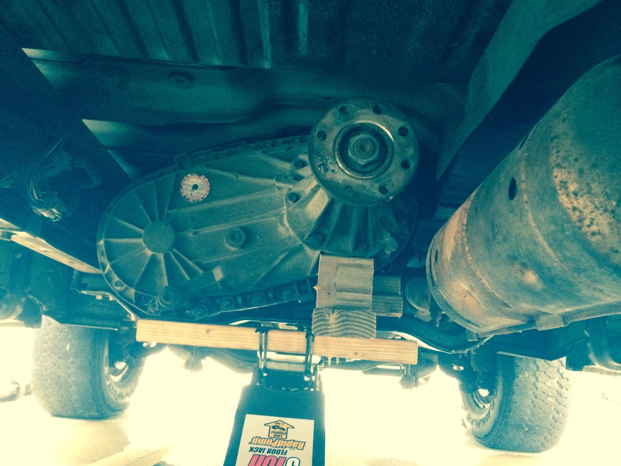

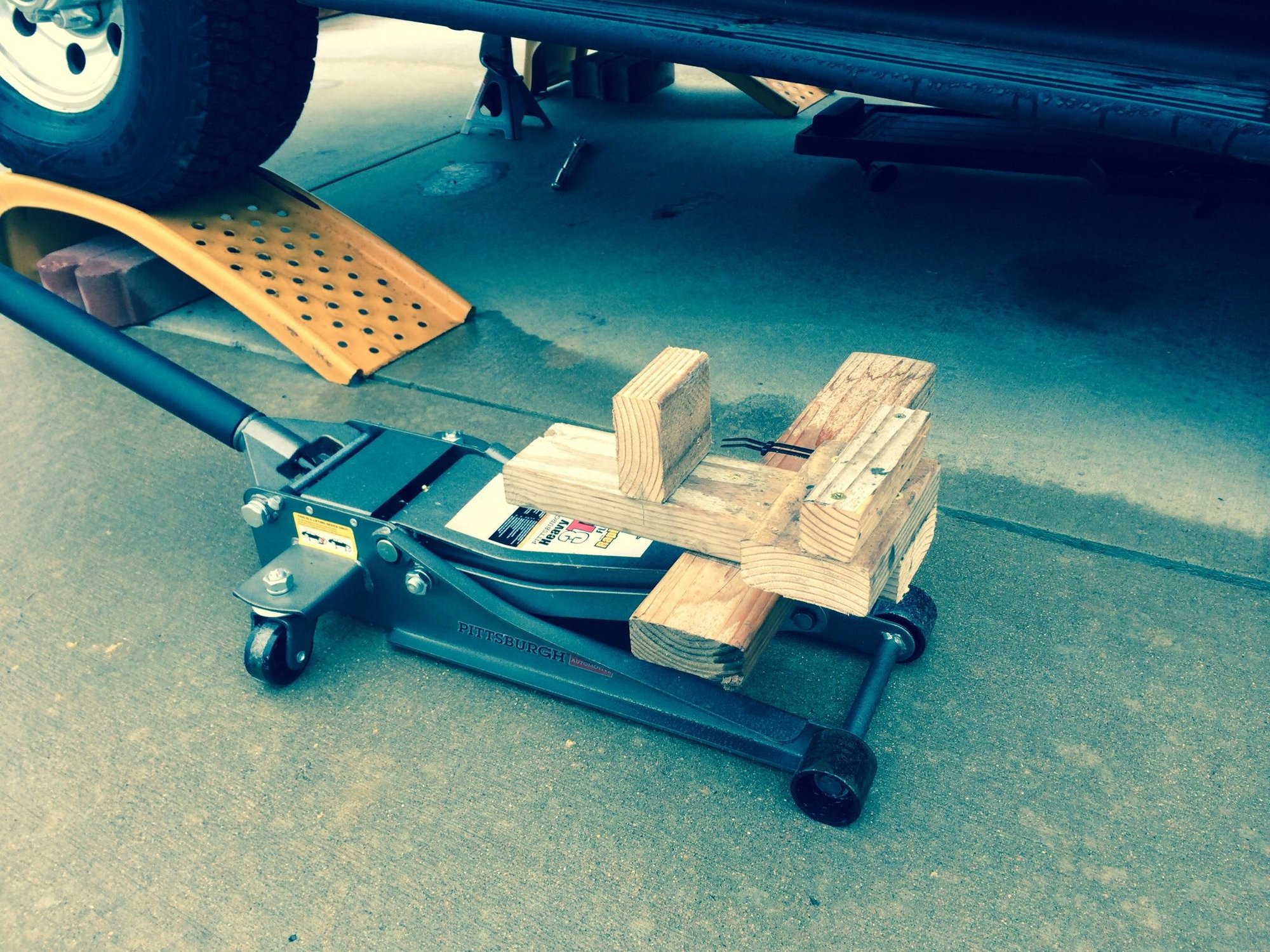

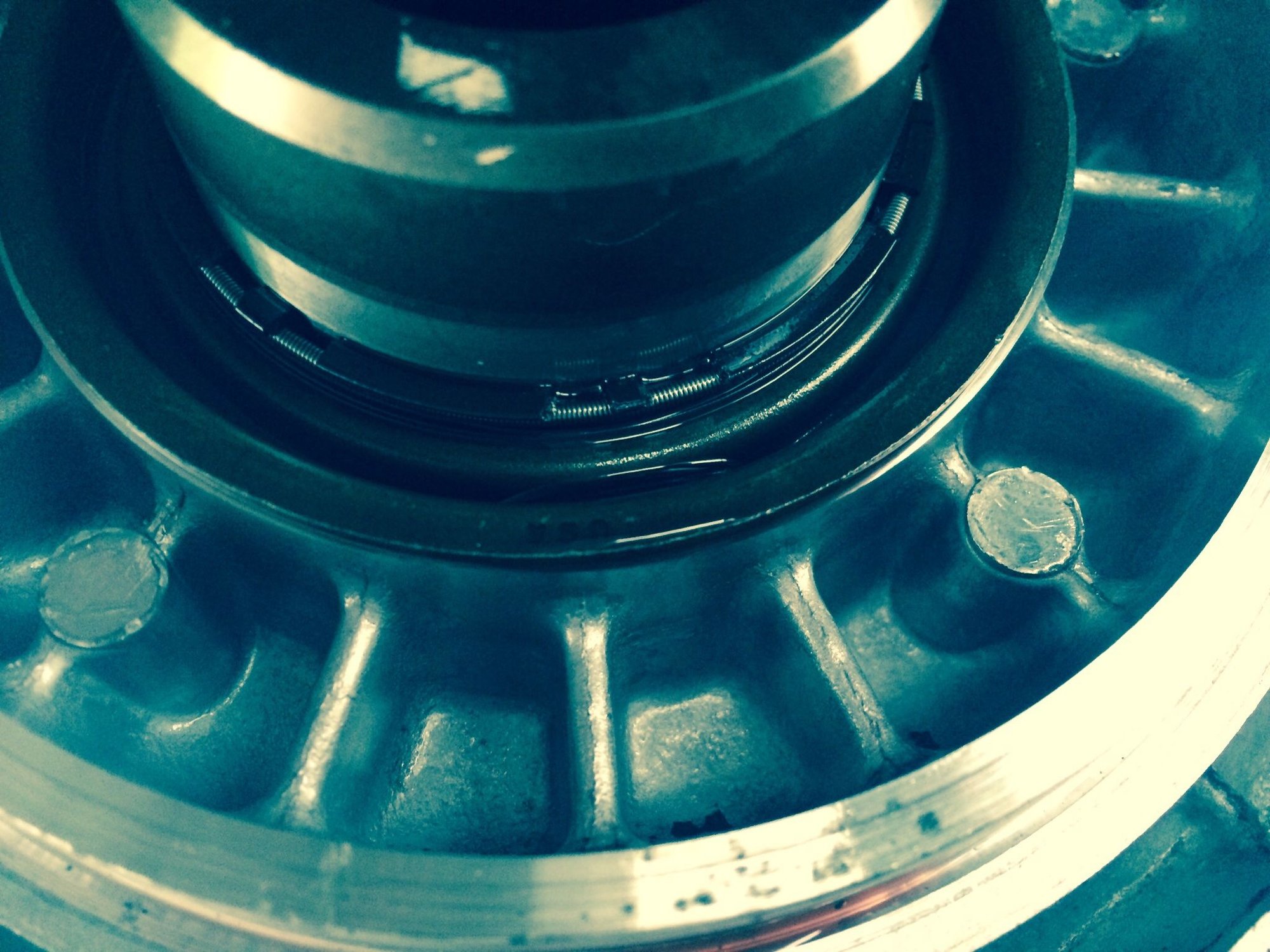

Really surprising all that weight being held by 6 bolts! No wonder they shake loose. I was missing a bolt and one was broke, so holding on by just 4. I built a brace on a Jack with 2x4's to support removing the transfer case and it worked perfectly. The hardest & most frustrating part was reaching up blindly to remove the bolts on top of the transfer case - very little room to get a wrench or socket up there but finally got it. With the case off and down I found the input seal is what was leaking so swapped that out (easy pry out with a chisel), and now I wait for the adapter.
