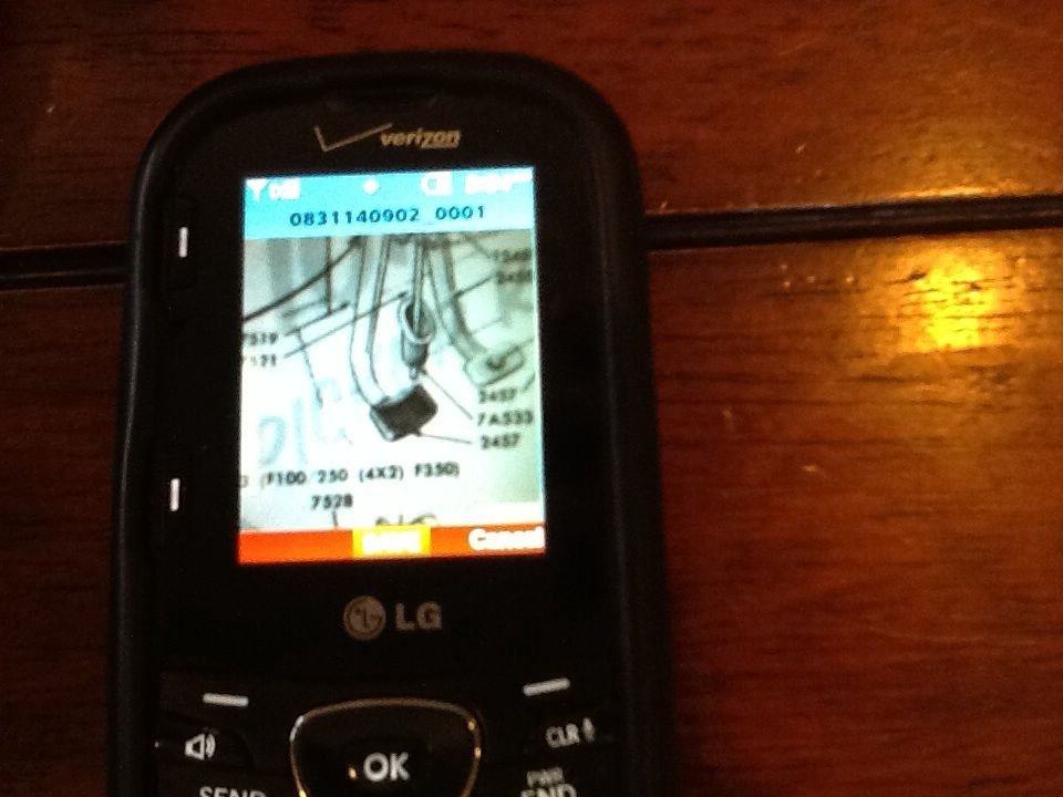

The schematic part # that I am interested in is 7A533. Does anyone know what this seal is called and where I may be able to locate it. What will I need to do to install it?

It's the clutch pedal rod floor seal. You can check Dennis Carpenters or any of the other repro catalogs. One of the parts guys might be around to get you specifics and even possibly locate a NOS part.

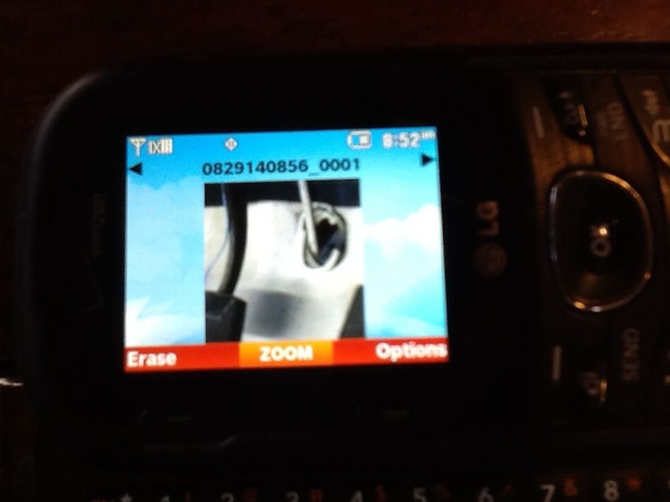

Thanks. It would appear that I would have to disassemble the rod to slip it through. What's involved with this type of work?

it should be a fairly simple process to detach the rod and install the seal.

Remove the kotter pin from whichever end of the rod is easier for you to get at. It's easier to get at the one under the truck for me. Pull off the old seal, put the new one on, screw down the seal flange and re-attach the clutch rod.
