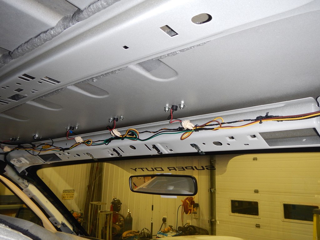

The factory cab lights are like 5 times the price of the Recon kit because you have to purchase each lamp individually, also they're equipped with incandescent lights. On a "just for looks" modification, that wasn't really worth the price premium for me.
I agree the screws the kit comes with are a joke, I threw those away, used machine screws and double nutted. Lots of silicone applied around all mating surfaces and holes, soldered onto the yellow-green parking lamp wire.
