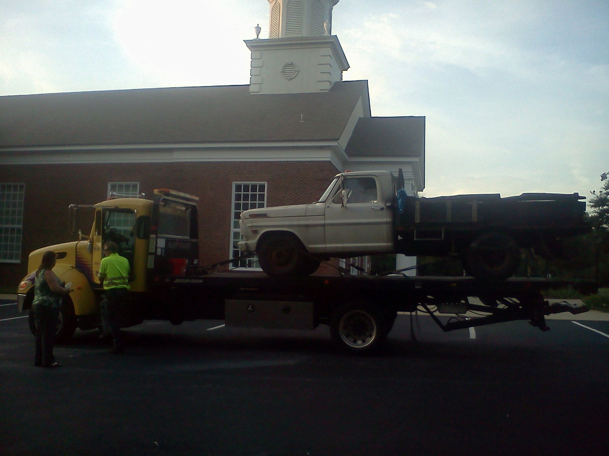

Was on the way to meet up at the BBQ place with fellow members when he sputtered and died. Then nothing but cranking. Pulled the air cleaner and could hear he fuel shot, but didn't see one and *no* smell of gas so called a roll back. $100 for two miles back to the house. I figure it's the fuel pump as it's original (74k miles) but I have yet to completely diagnose. I'll pull the sender and see if there's rust in the tank. Took the wife out for dinner anyway at Terrafin Station so not a complete loss. Maybe next time guys.

I cracked the line at the carb and spun it. No fuel up there at all. Unscrewed the sediment can and there's plenty there so I'm going with fuel pump. At least it's an easy swap. Points and condenser are new, but we all know how cheap today's modern versions of the old parts are. Pertronix in the future, maybe when I rebuild a 390 this winter. I was playing Russian Roulette with that one. Should not have trusted a 45YO diaphragm with modern fuel. Could have stuck me out there with a full load with the trailer loaded too. Just lucky it was me and the misses on the way to dinner.
