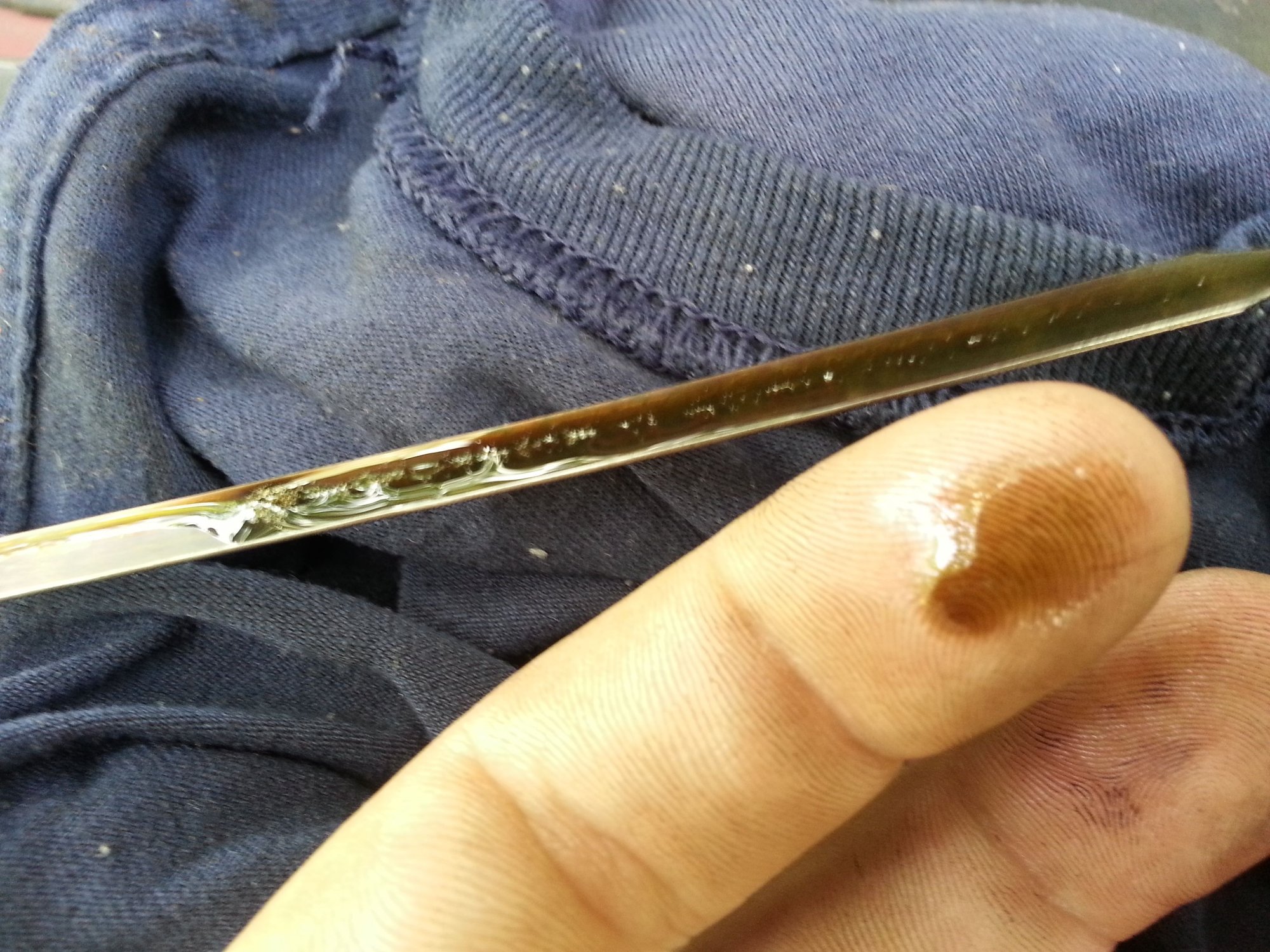

In the meantime. what i have noticed is bubbles on the dipstick after it has been running. ill post some pictures.
Disclaimer: i had a really hard time getting my phone to focus on something that close and i do not have a proper digital camera. so there were "opportunities" for better pictures with even more air but my phone would not focus without some fuss.
before i started the truck. sat over night.
Here, I started the truck and immediately walked to the front and pulled the dipstick. (5-10 seconds of running) those dots are not dirt or bearing material but in fact a ton of tiny air bubbles. debris does not pop and disappear like this.
These last three were after 2 or 3 minutes of idle. no revving. no driving.
More bubbles.
Had the stick out for a while at this point fighting with camera focus and watched a lot of the pop, run to the surface before this one took.
I dont know if that is a "normal" amount of bubbles. or if i am dealing with true aeration. but i have never seen any of my gas engines do that.

1. Is the correct oil being used? There are oil additives that will reduce / eliminate foaming. Although, that's not bad.
2. An oil analysis would provide some information as to the general condition and what it contains. That would be the best evidence since we can't see exactly what going on inside the engines lubrication system.

Never seen that in my oil. Do an oil analysis at black stone and see what happening. Its cheap enough. It has to be pressurizing some where, blocked CCV may be. That or your using the wrong oil.

how do i go about an oil analysis? does it show anything about foaming anyways as it all bubbles out. or would it show a reason for the foaming?

Google Black Stone and they will send you free sample jars and you send them in. It's about 30 dollars. And yes the CCV can get blocked. Is yours stock? If not it is usually the hose out to the back that get plugged.
