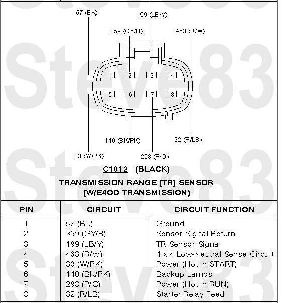

how do you identify pin 199 and 359 for testing?

mlps pin
mlps sensor values

- when checking the pins you insert the leads of the volt meter from the top (with the sensor connected) or from the bottom of the connector?
- what volt meter set up i have to use? ohm 2000? it's the only one that gives me values close to the ones in the chart. in N i get 1603 not 660/807 could it be possible?
