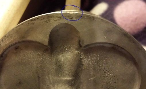

Hello -
I'm rebuilding my 7.3 idi and need some advise regarding the pistons. After pulling them out, cleaning and inspecting, I found the following issues with 5 of them. On the piston crown at the edge of the piston, just adjacent to the pre-comb dimple there is some pretty serious pitting that has resulted in a 'dimple' of sorts on the edge of the piston. I'm not sure if this is normal for an idi with 120k on it.
My question is, is this a problem where the pistons should be replaced? Or is this normal behavior for this engine?
Thanks in advance!!

Alot of times that spot is completely melted away. I dont see why you cant run them. Thats from running a little too hot.

This is the biggest issue with IDI pistons, and why you limit the EGT's to 1200. 6.9's are even worse for it.
If they are all like the picture you showed, they are still fine to reuse, but they can get a bunch worse than that.

Thanks for all the replies - I ran the worst piston down to my machine shop this am and they also said it's fine to run.
Interestingly, this is a NA engine, not a turbo so I'm not sure why the egt's would've been a problem.
I just bought this engine about a month ago as a replacement. I did a compression test and it had a couple low cylinders. The engine had been sitting for 7 years. After cracking it open i found 3 cylinders will solidly stuck compression rings, so, I'm glad I did pull it apart. This is my primary driver and trailer puller so I'm doing a good rebuild on it. Using the turbo off my other engine... should be good & solid.
I really appreciate all the replies. Thanks a bunch - I feel much better about running them now.

Erosion at the edge of the piston crown is caused by oil getting past the rings and detonating on the compression stroke.
Install a new set of molly rings and reuse the pistons. Yours actually don't look too bad.
Some of the late 6.9 and early 7.3 engines were built with Sealed Power chrome faced top rings produced in the manufacturing process (prior to plating) such that they had a relatively round edge at the top corner of the ring, which hurt oil control.
Later Molly rings are produced with a process that yields a sharp edge.
Exhaust gas temperatures have nothing to do with this problem.

Pistons I don't think are that bad. I bought 8 new ones for idit for about 300$, but that was awhile ago. Call Mahle I think the manufacturer.

If you had an EGT problem, the combustion cup area would be slighty melted and/or have small cracks.
