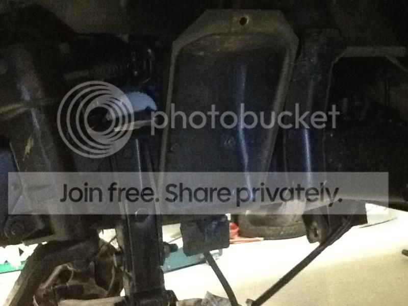

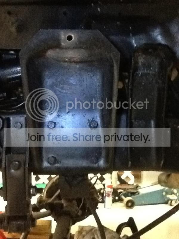

i am looking for extra lift for the front of my 79 f150. i was originally looking coil spring spacers but haven't had any luck finding any so i was thinking of just potentially moving the spring bracket? figured i could reuse the existing bracket and drill 2 more holes in the bracket to push the springs down and gain a couple extra inches? anyone done this? would it still be strong/safe in moving the bracket down?
i included pictures to give you an idea of the bracket i'm talking about it....

How much lift do you currently have? I see you already have a track bar drop bracket.

in the process of putting 9" skyjacker springs on the truck. it was sitting on 6" springs.

If you are going 9" then what's the need for a few more inches? What size tires are you planning on running?

42-44"s is my goal. recommended tire size with just the 9" lift is 40"s.

My point was you are going to be able to fit 42-44's with 9" of lift.
without chewing up the fenders in the process? I plan to offroad the truck.
If you wheel it for long, you will end up lowering it down to make it more capable Anyways its your truck, you can do what you want. What ive seen people do is drill a second set of holes 2" higher in the coil towers to drop them down on the frame which will yield 2" of extra lift. Slide a piece of 2" square tubing between the frame and the lower flange on the coil tower and bolt/weld it in to tie the tower to the frame better.

you can easily drop the bracket to gain the lift you want.
it has been done many times before.
You don't need to tie the bottom of the buckets together...it wouldn't do anything.
