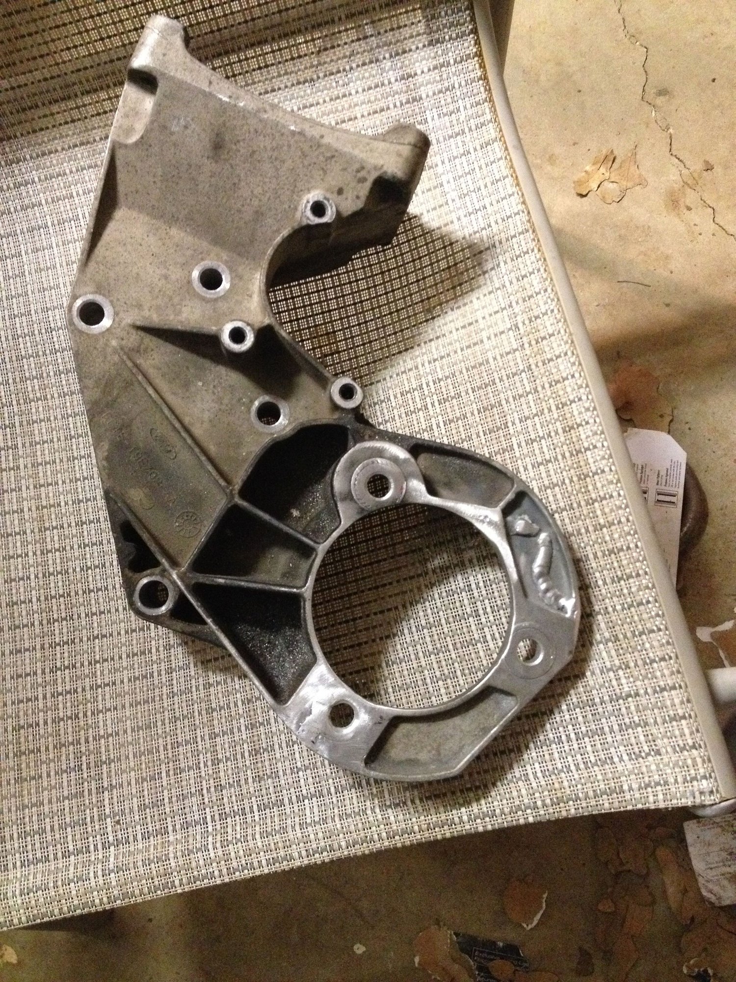

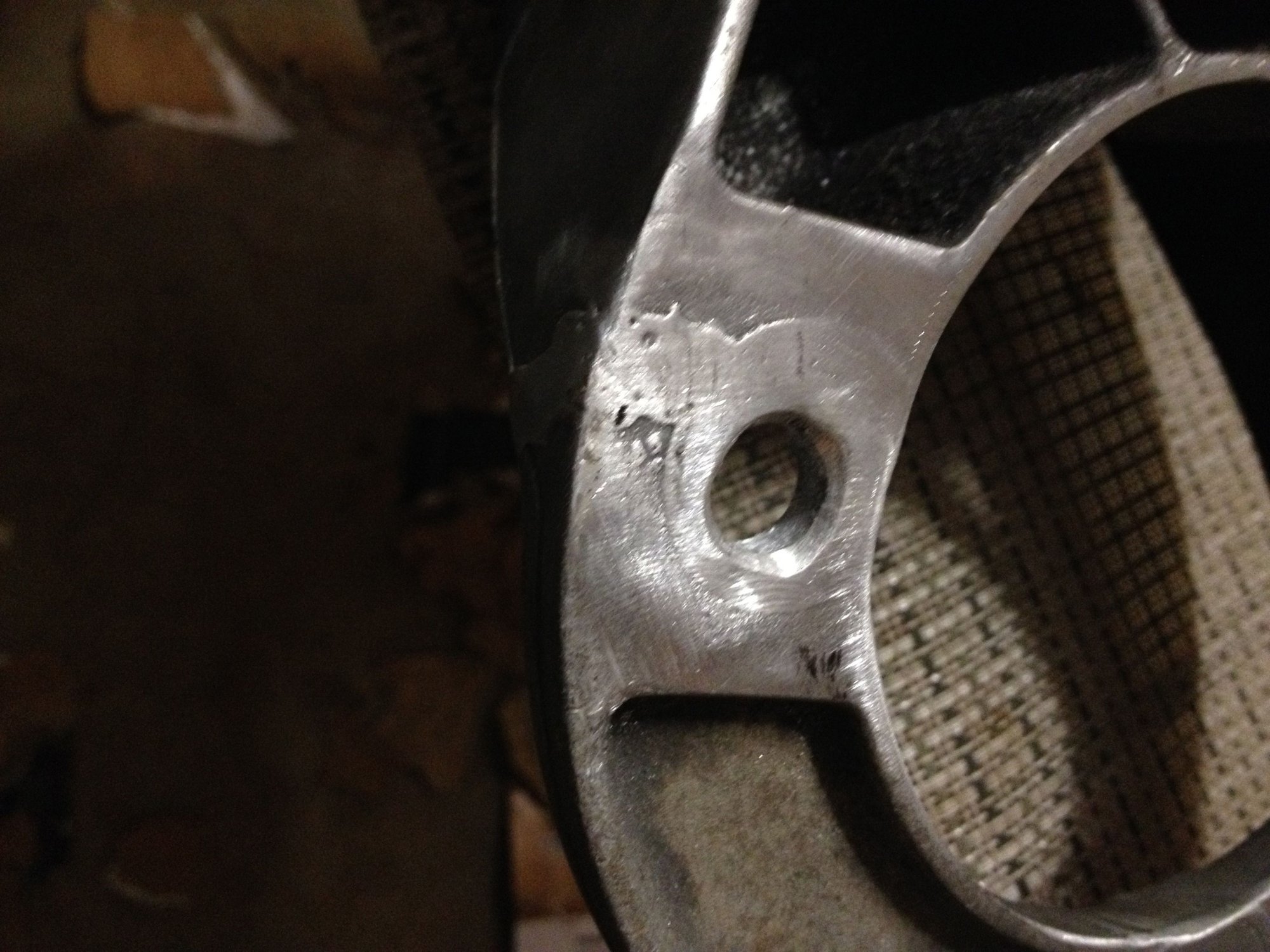

This morning I noticed a bolt head on the driveway. It was about the size bolt heads that I had cut during the axle swap so I just chunked it in the recycling bin.
Later this morning, after an errand, I started the truck and didn't have power steering or brakes. Turns out the bolt head broke off and I guess the rest of the bracket wasn't strong enough with just the other two bolts.

In looking back I had signs I should have recognized. Very surprising there is no margin built in though, loose one bolt and it fails.

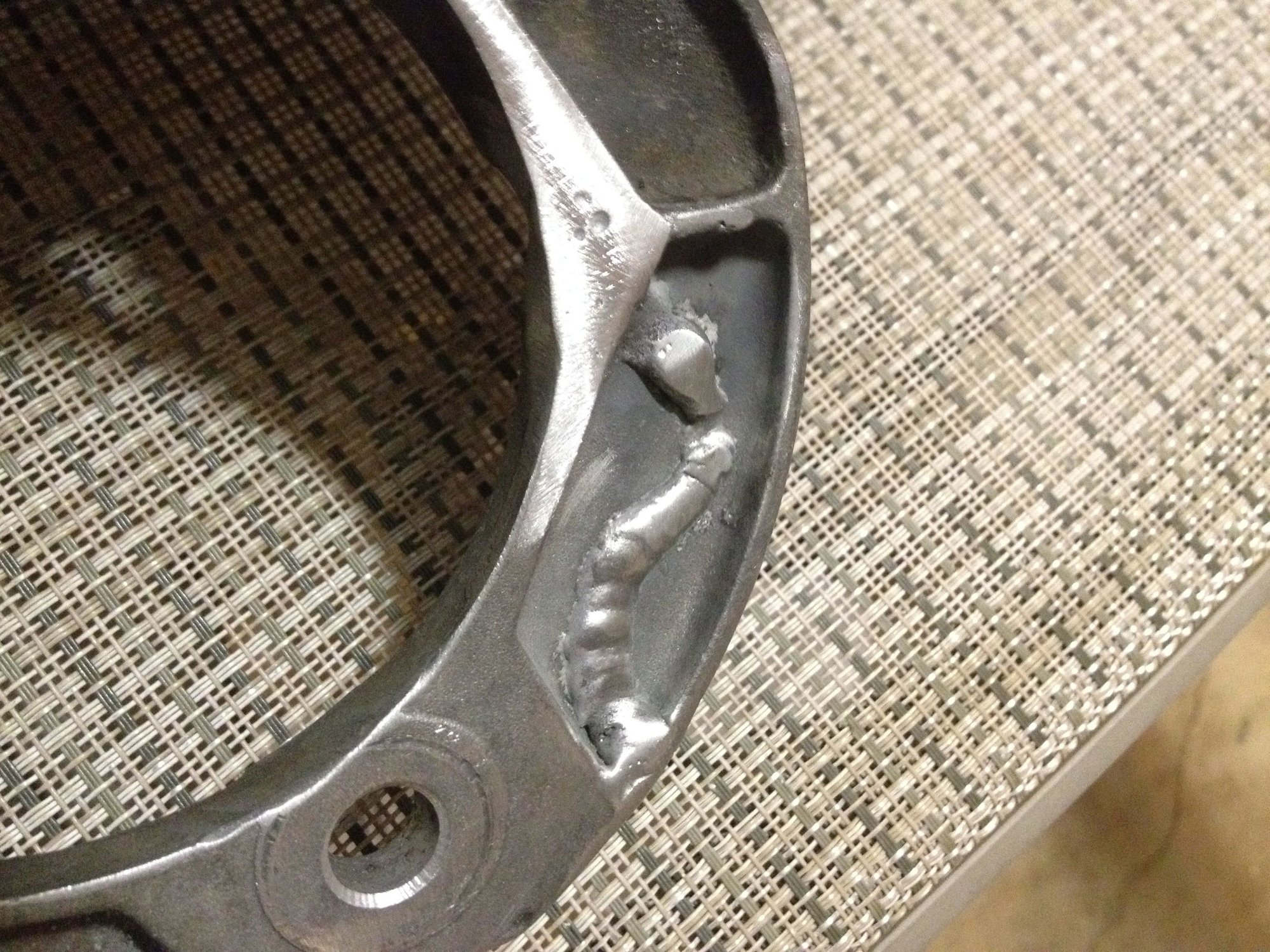

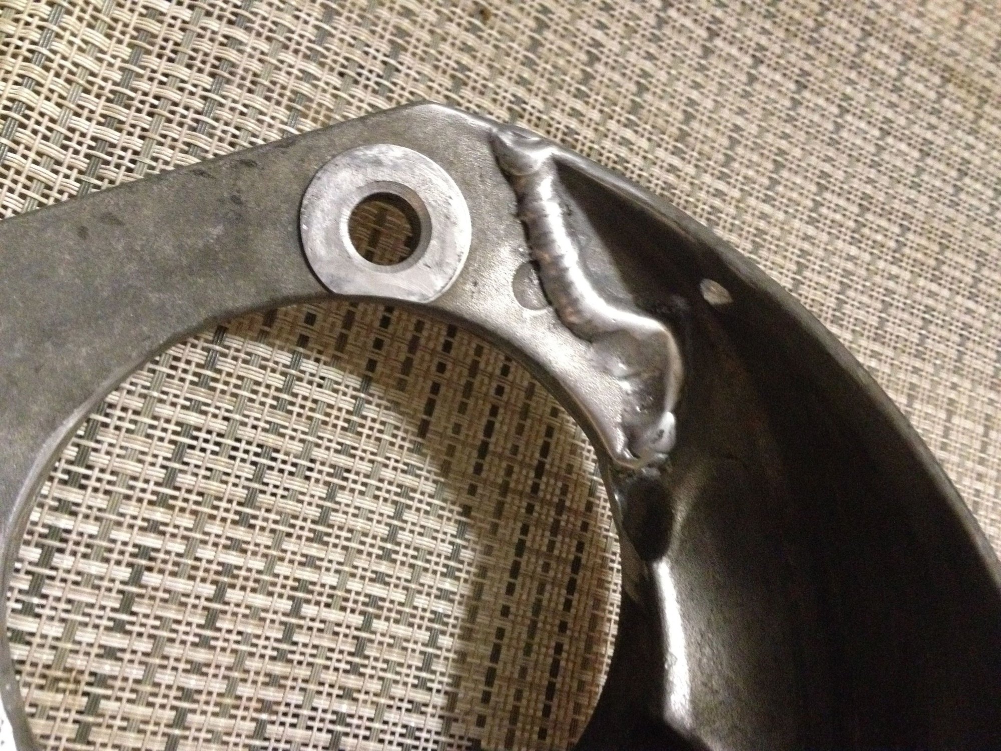

Local guy welded up the bracket. I'll keep it in the tool box to insure that I will never need one again.

Not sure i would trust that weld at all. Aluminum has to be CLEAN to be welded. That bracket is filthy and covered in oil
