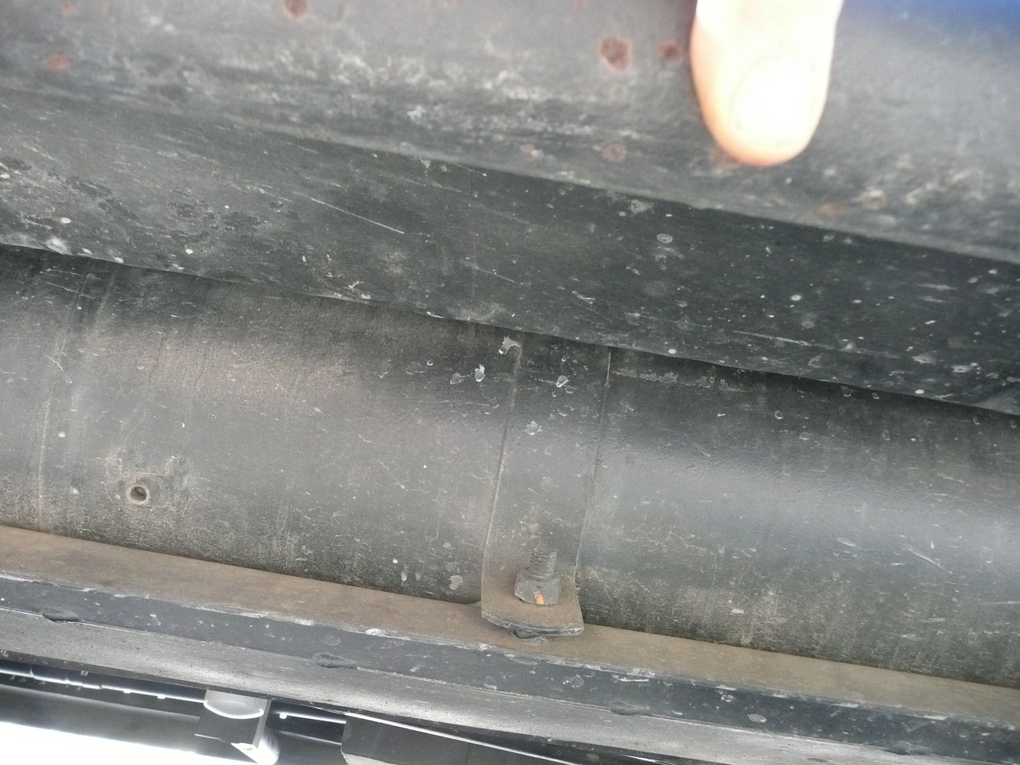

Okay Brian, here are the photos of the LPG setup .
This is the mixer and the electronics to run it all, it's in the LHF of the engine bay looking at the motor.
This is where they fitted the LPG filler along side the diesel filler
They supply the ID tag and do the reg transfer.
The LPG tang is 30ltrs which lasts about two tanks of diesel, the gas is only injected in when the revs are over 2200 IIRC
