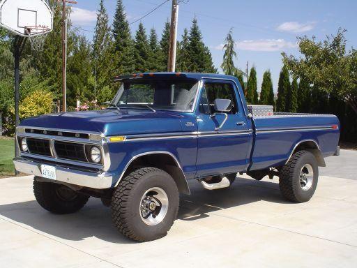

You should be able to fit a 35x12.5 with no problems, that is what I have on mine. You could probably go a little taller, maybe even up do a 37 depending on how worn the springs are. Here's what mine with 35s looks like, though I have longer shackles in the front to level it out a little.

Are those 16 inch rims? ^

They're 16.5s, 9.75" wide.
