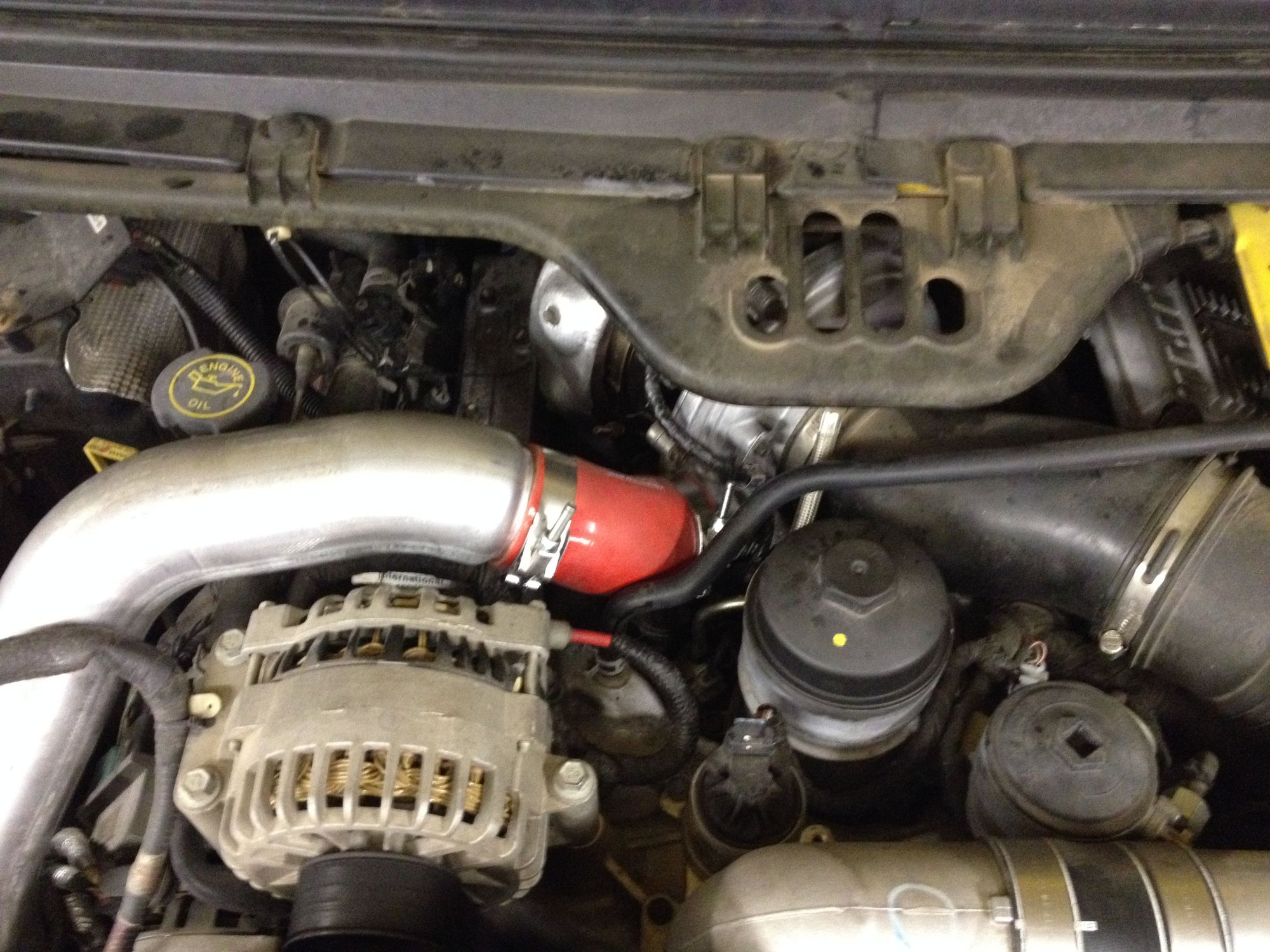

So I got the Riff Raff boots. Thanks for the pointers everyone. The blue was out of stock so I got the red instead. (not into pink).
Valley looks drier now, but I am still getting the smell of either burnt oil, or raw exhaust inside the cab when I run the fan (AC or heat).
Anyone have ideas? Exhaust leak around turbo maybe?

Exhaust in the cab can be exhaust bellows leaking. Get underneath and follow the pipes from the back end of the exhaust manifolds up to the turbo, and check for soot on the firewall insulation.
The braided thing on the left and the two accordion things like in the upper right:

hmm, looks OK around the bellows, but upon closer examination, I see soot on the head where it looks like it is coming out of the exhaust manifold gaskets, or what is left of them.
Also, I see the some oil on the head gasket on the rear of the passenger side. I think/hope this is from the valley above, and not head gasket.
Is this getting off topic? My original reason for looking was the smoke in the cab, which I attributed to the leaking CAC tube. Maybe a combination of things.

On the head to exhaust. As I understand it they don't have
a gasket to start with. They can be added later in life if needed.
The oil on the passenger side is most likely from the CAC boot
at the turbo. They tend to weep some of the carry over oil from
the CCV.
One way to find a leak if you have a compressor would be to
make a cap you can put on the tail pipe and pressurize the
exhaust system and go leak hunting. This way it's cool and
not running engine HOT. Also this way you don't end up
with crispy fingertips. OUCH
Sean
