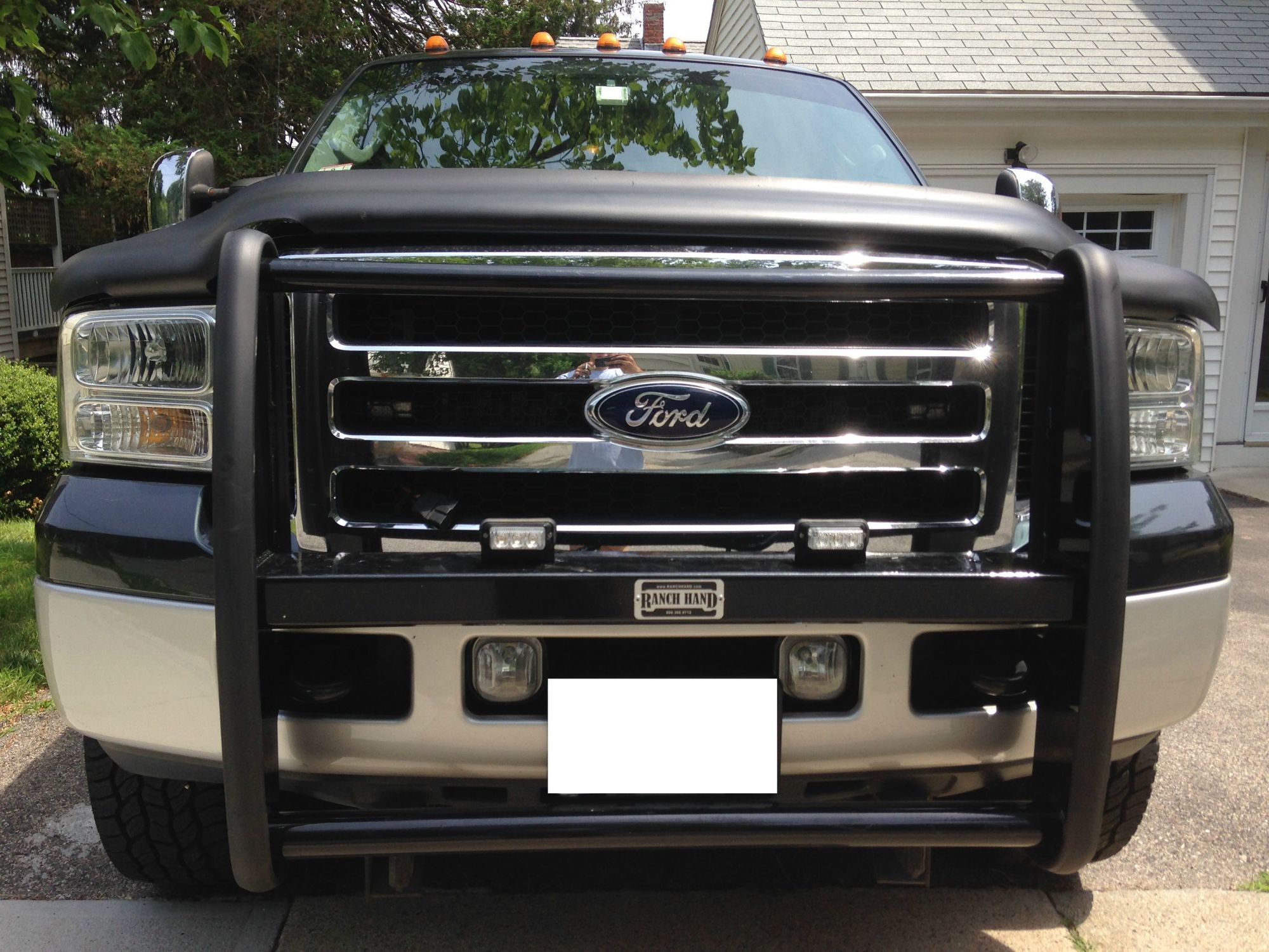

Alright so here's the front end. The strobes on the push bumper are wired into a harness that then uses a 4-pin trailer connector to plug into the harness for the other two grille strobes. When they're plugged in, they're powered and synced to a set pattern with the grille strobes. If I take the push bumper off, they unplug with it and the grille strobes revert to a secondary pattern.

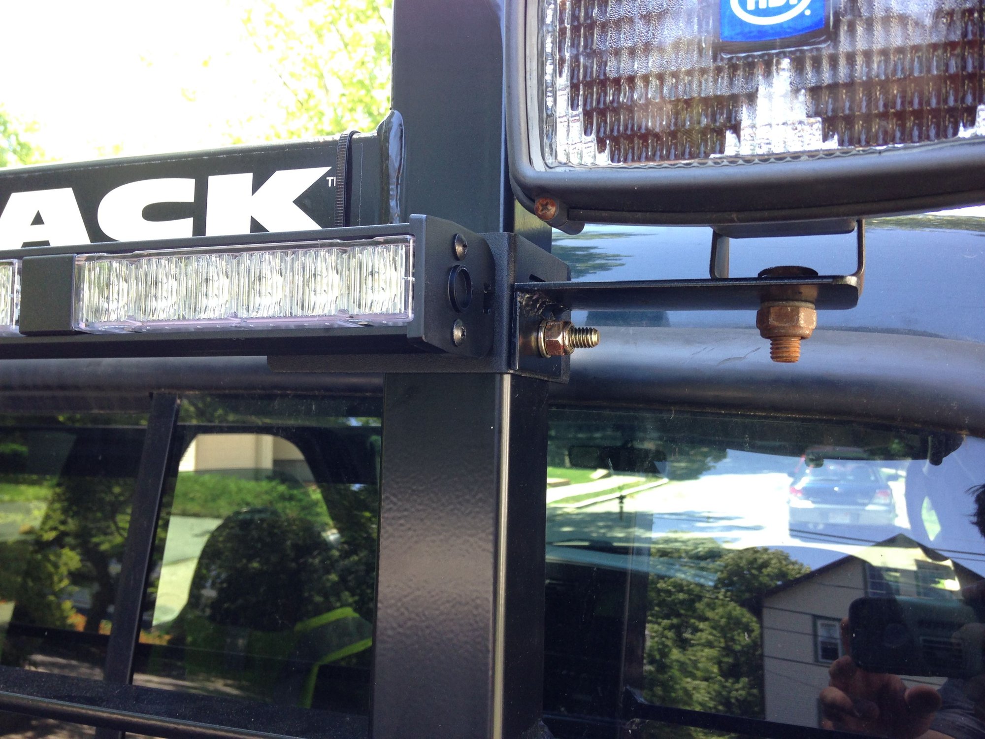

The rear bar here is mounted right to the back rack with the factory drilled mounting holes, using a second bracket I made that mounts the flood lights.

Nice clean set up

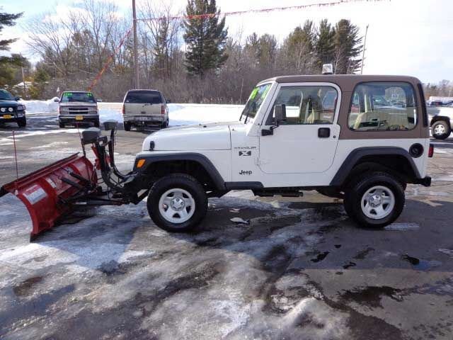

Put the strobe on the roof where other people can see it - not in the grill or under the tailgate where it will be blocked by the plow or ice/snow on the back bumper.
Even if not blocked, the one thing you don't want is that flash reflecting off that pure white snow and back in the plow driver's eyes at night..
Here is my Jeep with a simple revolving strobe on the roof.. Works great and is mounted permanently.
