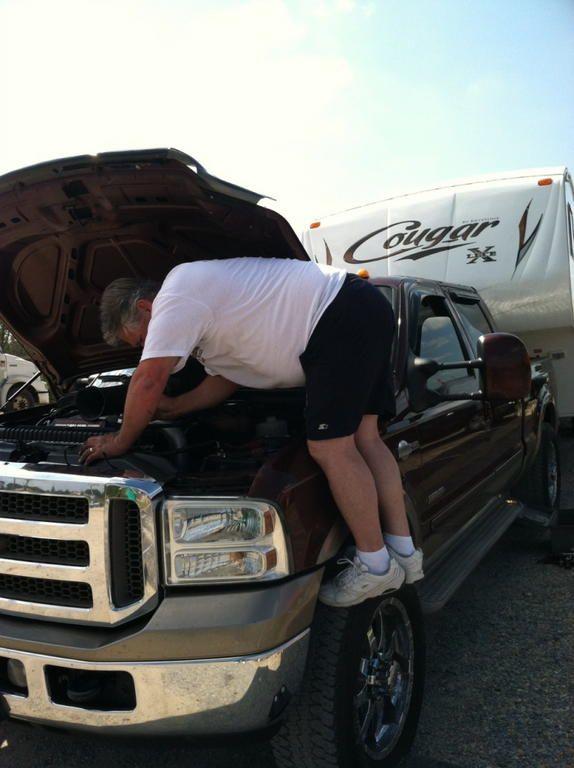

I put the Riff-Raff kit on my '06 a year or so ago. Lines right up withe the elbow, no mods necessary.
Just a little tip. It's pretty oily and hard to reach down there. The blue boots will slip if you don't get everything spotless when installing it. My popped off a couple of time on my first trip and getting it back on on the side of the road isn't fun havin to pull the air filter out:
^^^------You don't want to do this!
I used the old clamps off the plastic tube and double clamped the the bottom boot. I also trimmed about an inch off the bottom boot length so the metal pipe didn't sit against the front of the engine. It's easy to see how it should line up. Haven't had a problem since.
