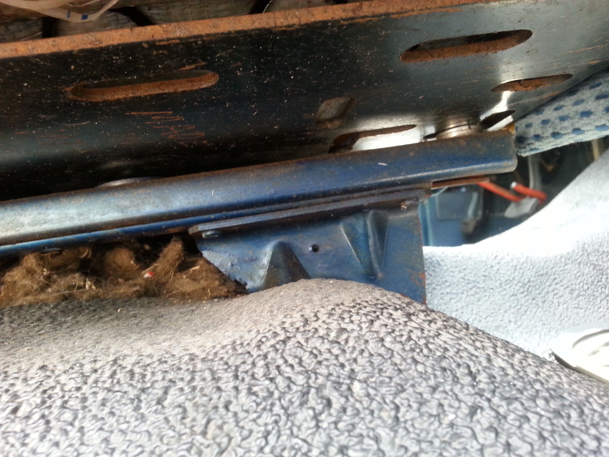

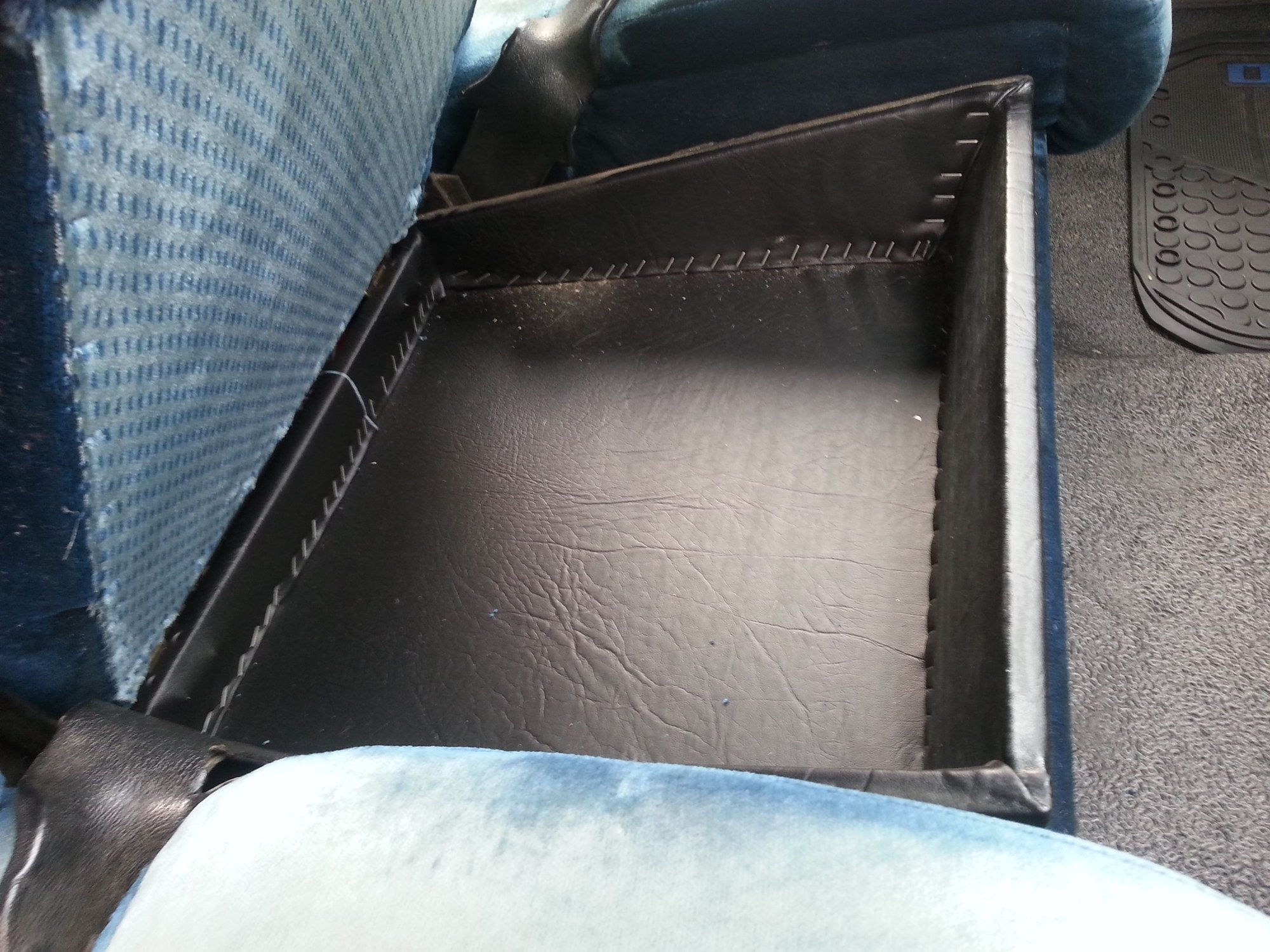

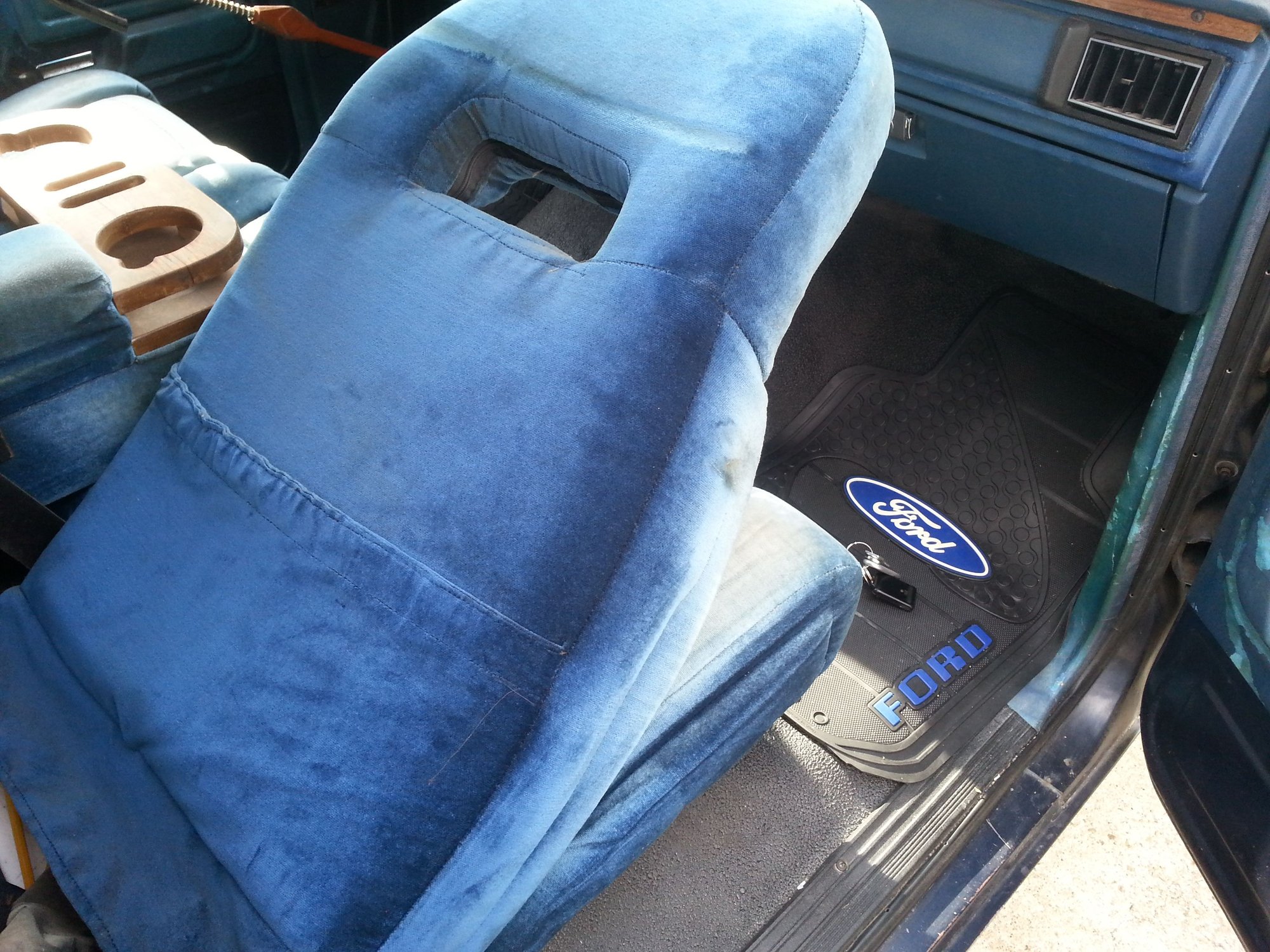

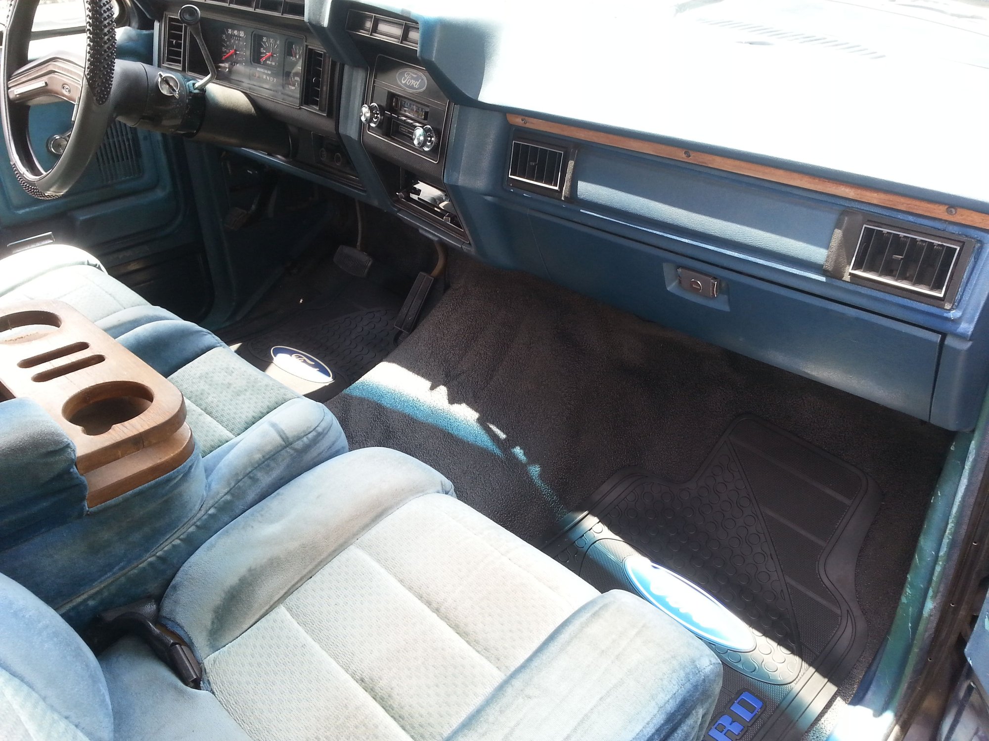

Heres some photos of the seats. I even included photos of the OE track and the spacers used to raise the seat up some. Cant remember though if it was for clearance or for raising the heigth of the seat up some.
