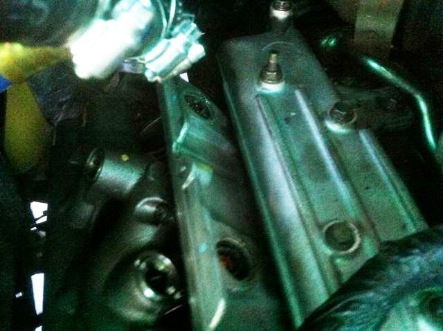

Anyway with it all back together I want to retest #7 injector
for the contribution to see if moving the plug around helped
or not. That was one of the plugs that were beat up.
Let me see if I have any more photos to share.
My friend for stuck bolts. Heat them up and spray with Kroil. Works like a charm
RTV crumbs all over the place

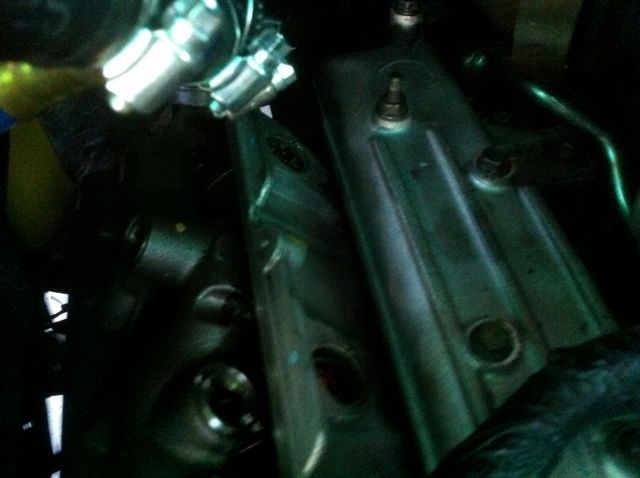

Don't know if you can see the injector plugs or not.
More RTV

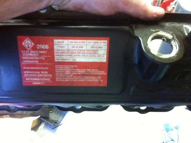

The tag

Here is a better photo of the nasty injector plugs

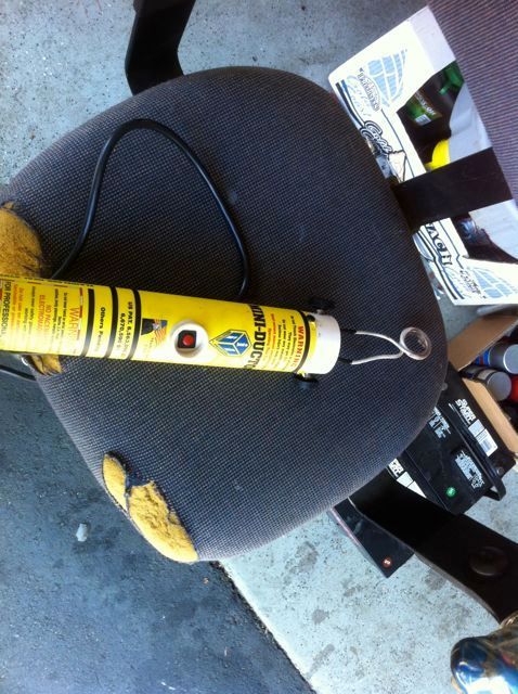

Hmm, I thought it was you that had one. Well I went looking for one
because of you guys that do this day in and day out. Someone had
one at work but that is all I can recall now.
I nailed that one on Ebay for $250 I think. The guy was a dealer and
it looked to be a demo unit. So it was in really good shape with all
the papers and what not. What I need to do is get some more coils
and some of the pads. They say you can pop small ding type dents
with it.

Iirc I posted something about once, there are diy plains for them too. One of the coolist tools ive seen

I looked at the DIY projects and thought about it. The Min- Ductor is
almost a DIY looking tool. At least it not in a PVC pipe with PVC end caps.
