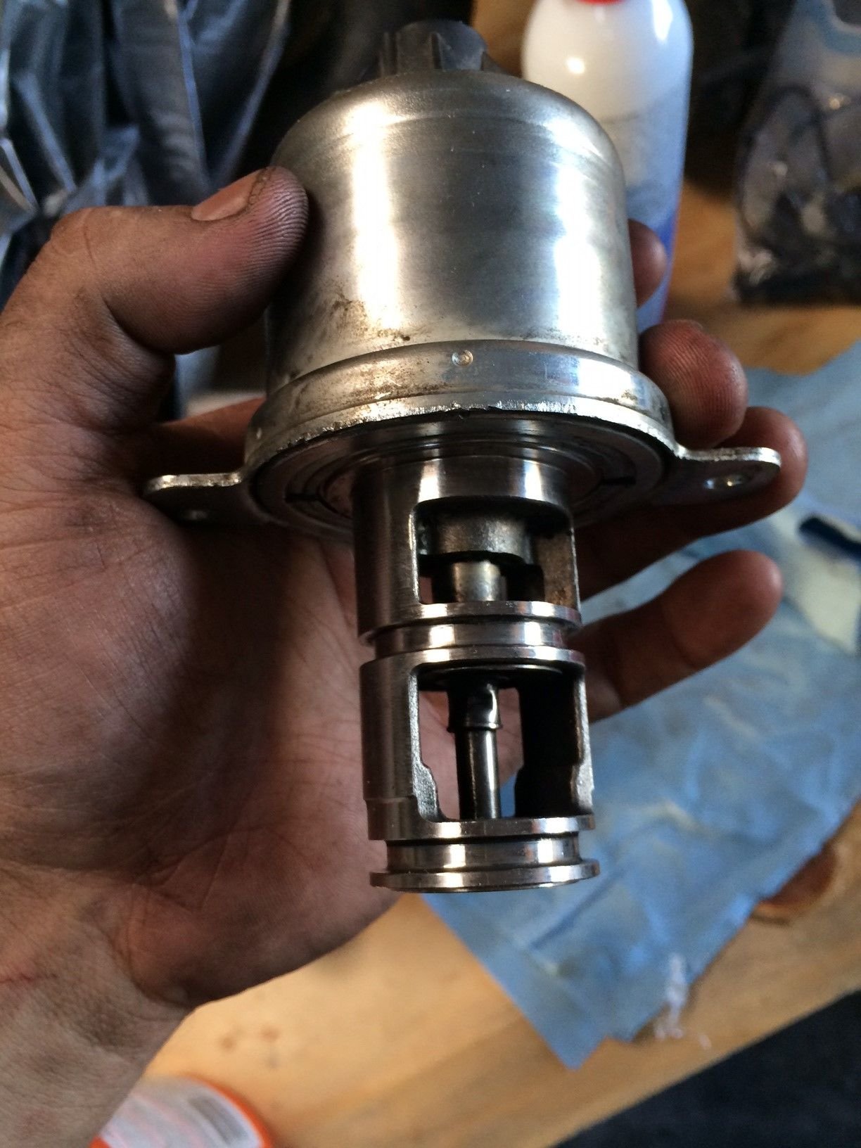

How often do you drive it? Could be the VGT vanes rusted to the unison ring, one of the bellows on the y-pipe or up-pipe leaking, or it could be on the pressure side with a torn CAC boot or split hose. You can also pull the EGR valve and clean it to make sure it's not hanging open and bleeding off exhaust pressure.

The upper boot on the turbo has a bad habit of splitting on the bottom where you have to remove it to find the tear, and the plastic hose can split at the accordion where it's hidden pretty much under the driver's side battery.
A random issue that absolutely kills boost is the MAF being unplugged or messed up, but that normally throws a code. VGT wiring connector on the turbo (the only wire on it) can crumble if it gets hit with anything, that might not throw a code because there's no sensor on the VGT solenoid to know the actual value versus the commanded.
Don't rule out exhaust leaks, the flex joints fail randomly without any real reason to it. EGR valve cleaning is very easy to do, simple issue to rule out:
https://www.ford-trucks.com/forums/4...egr-valve.html
