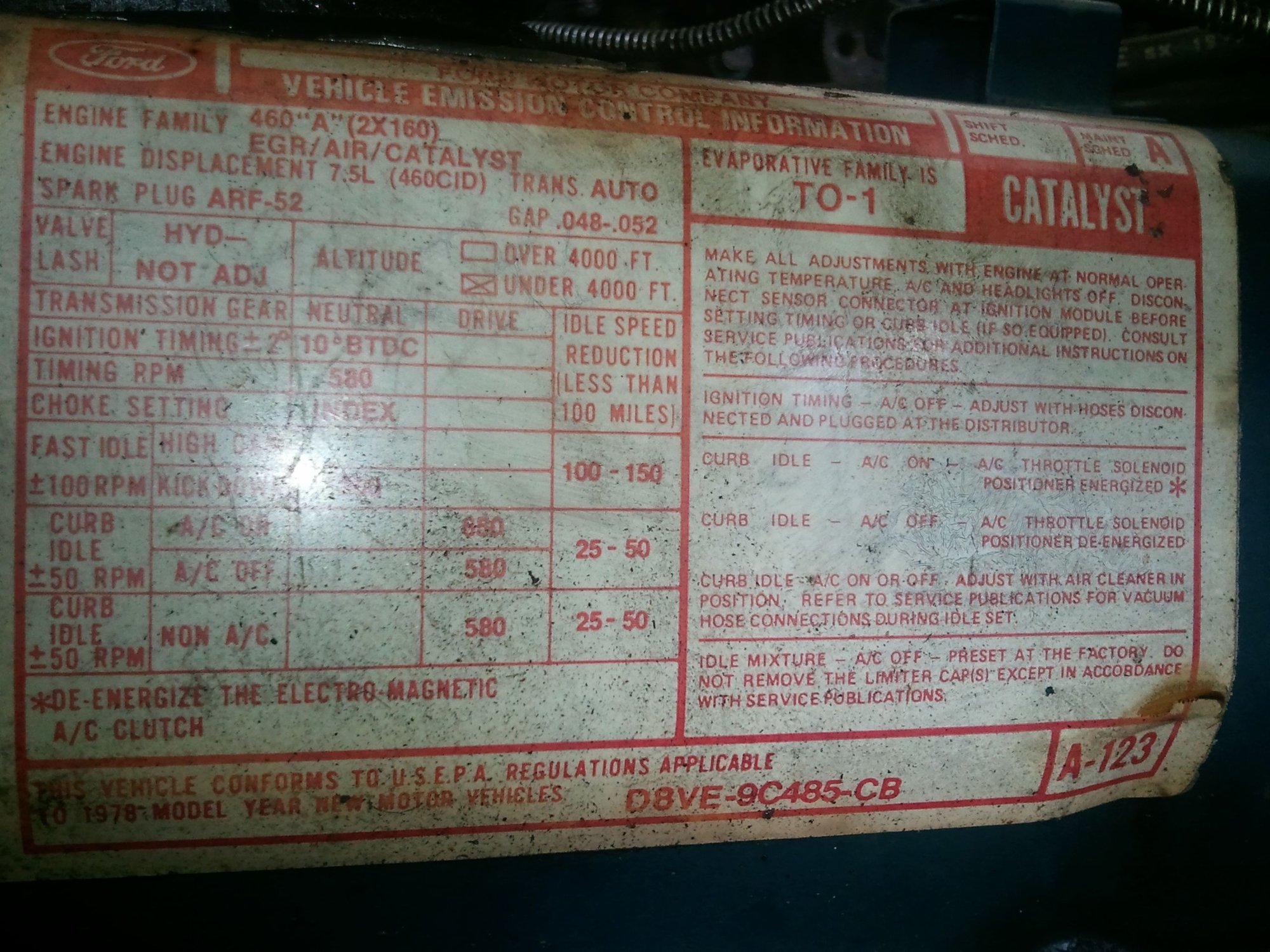

I have a 1977 with a 460. I think the low speed jet needs cleaning and I cant find a break down of the carb. the tag says E5HE DD A 7D10.

Is the motor and carb stock to the truck .. If it's 4wd then the motor is a transplant for sure .. Take a picture of the carb and post it ..

This carb is not the original...if this tag number you typed is correct.
ID number: E5HE-DD = Ford part number: E6PZ-9510-AJ (Motorcraft CA-3477). Carburetor parts list #5M
Applications: 1985/86 F250/350 351W 4V/460 4V
Pic of carb at left (lower).

the truck is 4x4. I have only had is for a month or so. I do not know the history of it. I am unable to upload pics, but I may be able to email you if you can inbox me your email. the carb says holley made for motorcraft

460 with 4WD? Engine has been swapped, as 1983 was the first year the 460 was available with 4WD (and a M/T), F250/350 only.
E6PZ-9A586-C (Motorcraft CT-1541) = Carburetor Kit = listed following ID number in left upper parts catalog pic (post 3).
Carb pictured in post 3 at left lower. Here's what this kit contains, notice there are no jets:

It is an emissions motor and looks like the holley/Ford 4180 carb .. Do yourself a favor and remove anything flammable from on top of the intake .. The E5HE means it is 85 or newer I believe and 87 was the last year of the carbureted 460 so we're narrowing it down .. What state will it be registered in and do you have emissions testing ? Also cap off the 2 bowl vent tubes one coming out each end of the carb if your not going to be running an evap system .. Is there a canister on the passenger side frame under the battery (or maybe 2 if you have 2 fuel tanks) with a line running back to the fuel tank ?
The kit for it http://www.ebay.com/itm/Holley-3-1346-Renew-Kit-Carburetor-Rebuild-Kit-Extra-Parts-For-Perf-Tuning-/161229670234?pt=Motors_Car_Truck_Parts_Accessories&hash=item258a09875a&vxp=mtr
