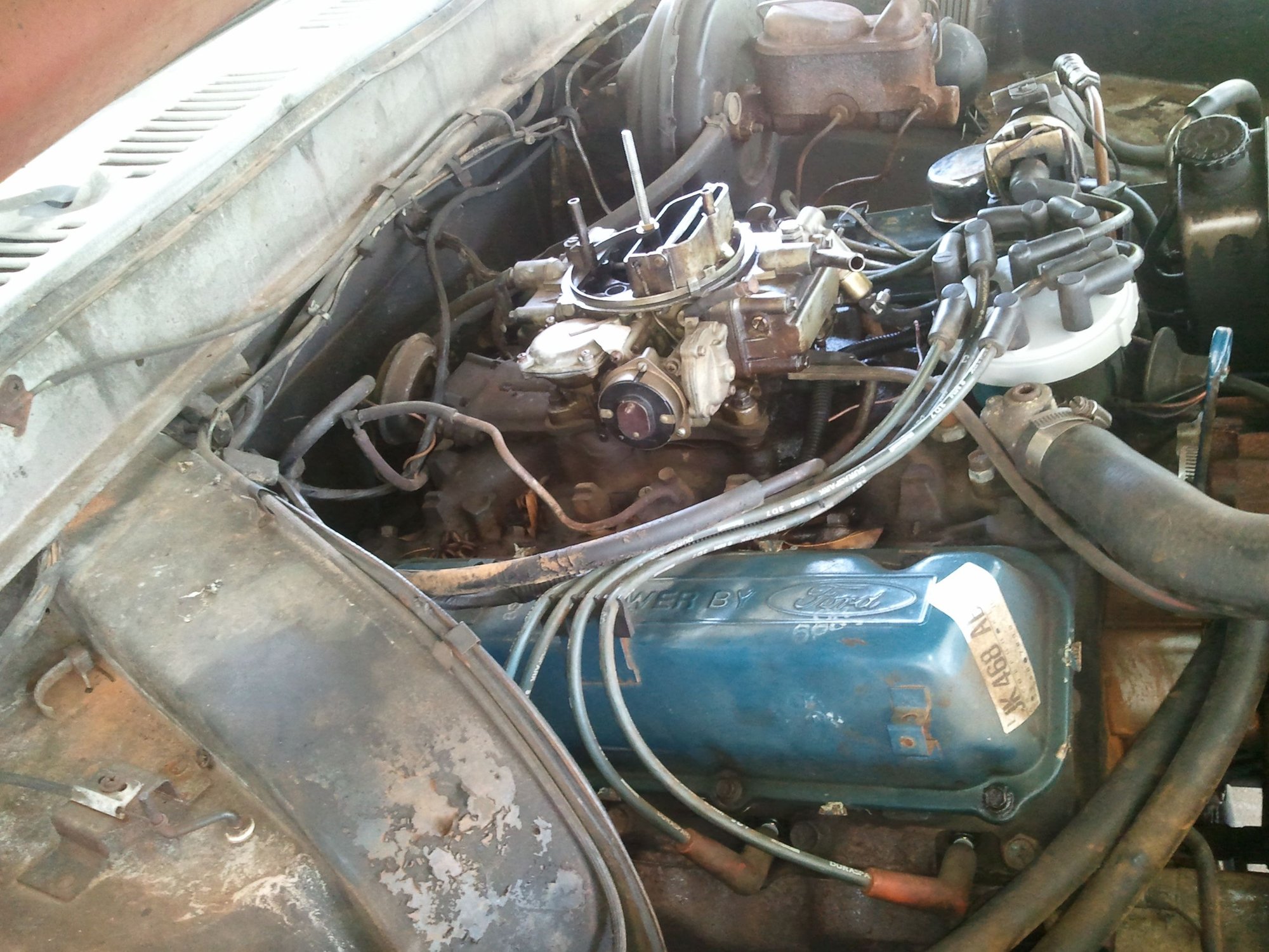

What u think about this number dummy ? Also look at my previous valve cover pic. Bottom left corner says 1978. Did they start the 460 then? Need to make sure the Holley 4180 is equilivant to my carb before I spend the money on a rebuild kit.

First you didn't bother to answer any of the questions I asked you and now you question my I.D. of the carb .. What gives ? If you would have done some research on the kit one of the first places you would have found is this .. Scroll to the bottom of the PDF and you will find your carb ID ..The carb is actually a 4180C .. I'm running a modded version of this carb on both my 460 and 390 motors .. The carb in it's stock state needs some work but it can be made into an awesome carburetor with some bolt on modifications to overcome the emissions design .. If your interested I can lay those out for you .. That is definitely the holley factory kit for your carb with the parts upgrades needed to burn 10% ethanol fuel .. I would not have pointed you to it if it wasn't right .. I have used that same kit to rebuild 3 of these 4180C carbs all were E5HE's which is the desired core when building one for a 460 ..

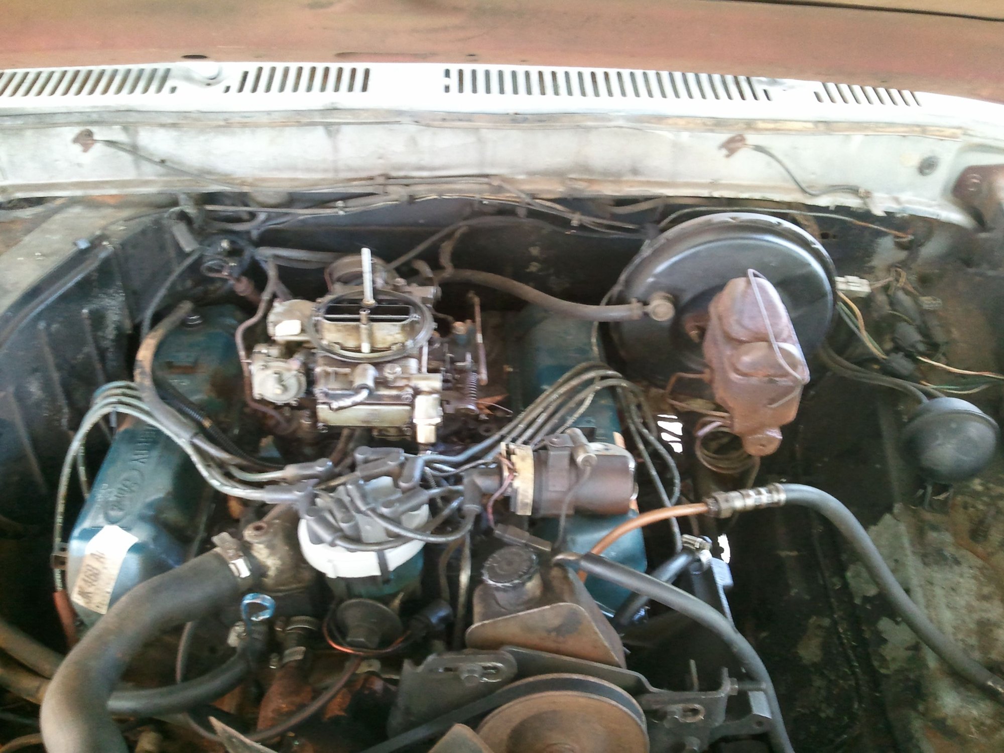

Interesting picture .. If the motor matched the carb it would be painted grey .. You may have gotten lucky .. Nice saginaw power steering pump BTW that's a transplant or this is a van motor .. This is a good indication whoever put this motor in may have known what they were doing .. The motor may have come out of a van (econoline) .. With the dipstick in the front this must be a front sump oil pan ? So came out of 2wd something .. Looking more like a Van motor .. What are the casting numbers on the heads ?
One thing that would be helpful to further ID what you have is when you pull the carb take a picture of the intake where the carb mounted ..
It doesn't look like the electric choke is even hooked up ?

The egr valve is hooked up. I pulled it off while running and the line did have suction.

No wires going to the choke. I thought it was a mechanical choke, as the motor heats up the butterflies open.

That doesn't prove the egr valve is functioning as it should ..
