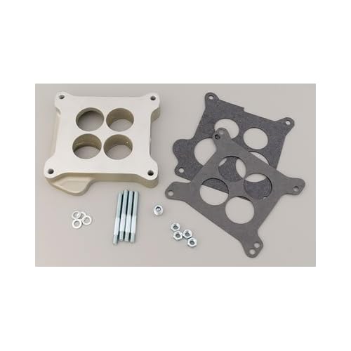

On your intake you'll want to use the
Trans Dapt 2199 Trans Dapt 2199
to either go from the egr plate to the 4180c carb or from the intake to the 4180c with possibly a phenolic 1" spacer ..

What is the purpose of the spacer plate? I have to get this thing running, I have to take for a state vin inspection so they can issue me a title.
