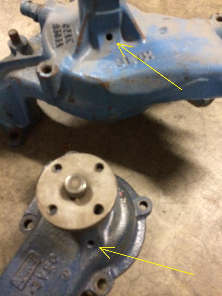

I don't have a 351W water pump, but here's some shots of an FE style and 240/300 I6 style water pumps. I've added yellow arrows pointing to the weep hole on each one. In line with and directly below the pump shaft.
General steps would be.
1. Disconnect battery (just to be safe)
2. Drain radiator
3. Disconnect radiator hoses and heater hoses and pull radiator (this is often quickest and sometimes required for step #5)
4. Loosen accessories that share any fan belt that shares the water pump pulley.
5. Loosen and remove fan bolts, fan, spacer and pulley
6. Loosen and remove water pump bolts
7. Tap water pump housing gently to break loose where it mounts to the engine block. I like a dead blow hammer for this.
8. Scrape off old gasket and prep engine block for new water pump.
Install is reverse of removal.
Attachment 101518
2. Drain radiator
Adding to this list. Make a drawing / outline of water pump on a clean piece of cardboard. Make sure you identify all the bolt holes. When removing bolts place in the respected spot on the cardboard. do this until all bolts are where they came from and now on the drawing.
Some bolts may be longer than others. You want to make sure you get the bolts in the right spot when re-assembling.
