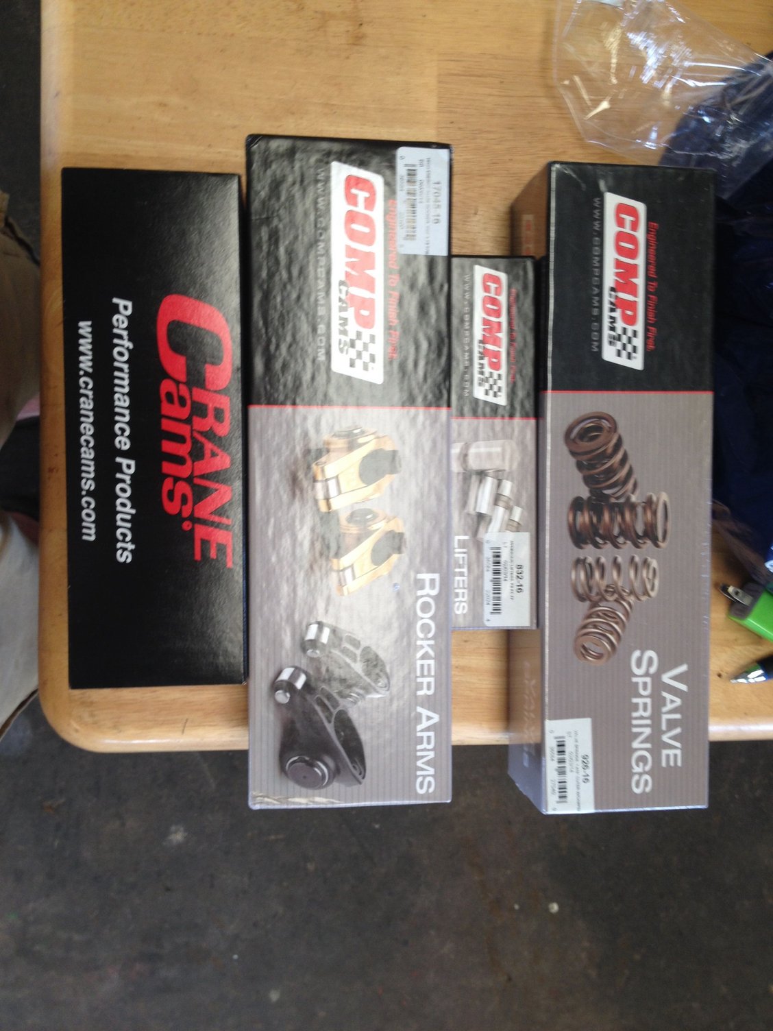

Santa Claus finally pulled thru for me<br/>
Old Jun 28, 2014 | 08:43 PM
  #42
Gary Lewis's Avatar
Gary Lewis
Joined: Jul 2010
Posts: 32,875
Likes: 48
From: Northeast, OK
I called it "birthday" when my stuff came in a month or so ago. But, Christmas in June works for me as well. Hopefully last Christmas?
