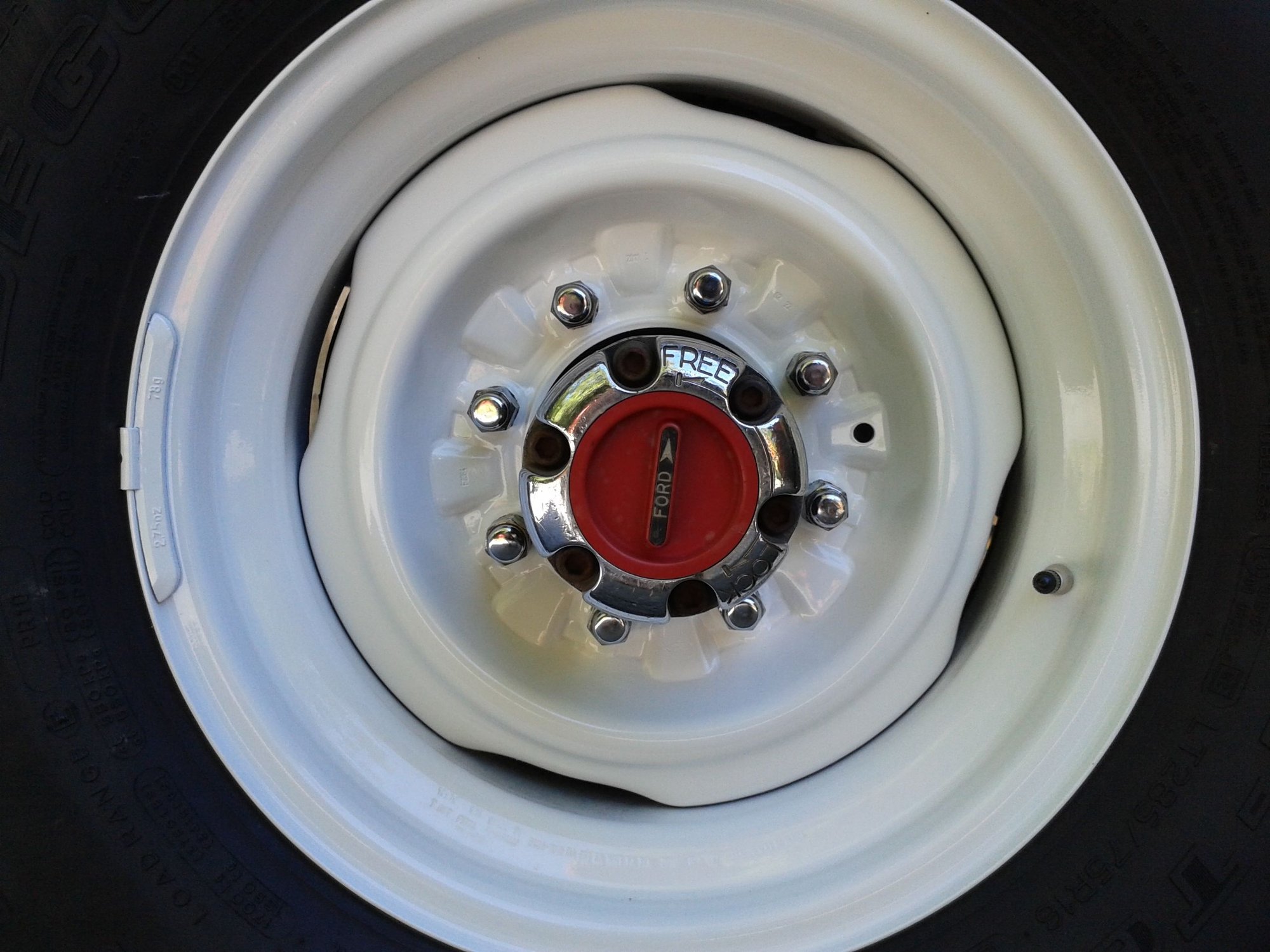

Here are some photos of the new take-off 16x7 Econoline steelies. As said previously, the only downside is there are no lugs for the stainless steel hubcaps if you are so inclined...
The selection of tires available for 16.5 rims is a bit limited these days so if I were you, I would hold out for a set of 16 inch rims.

hey westcoast those are awesome! Where did you get them?

I bought them off a guy on Craigslist a while back for $100.00 the set. They were brand new take offs from an Econoline and they seem to turn up pretty regularly on Craigslist up here.
As far as I know all Econolines up to present day still use the same bolt pattern vs F series which went to metric sized rims back in 1999.
Check your local want ads or even junk yards as there are lots of Econolines out there.

The truth is hub caps are the first casualty when you go off road and as long as you cover the threads of the stud with some nice lug nuts like Westcoast has you've accomplished the only practical reason for having caps .. There are several votes for 16's so far for a good reasons ..
Nice truck BTW Westcoast
