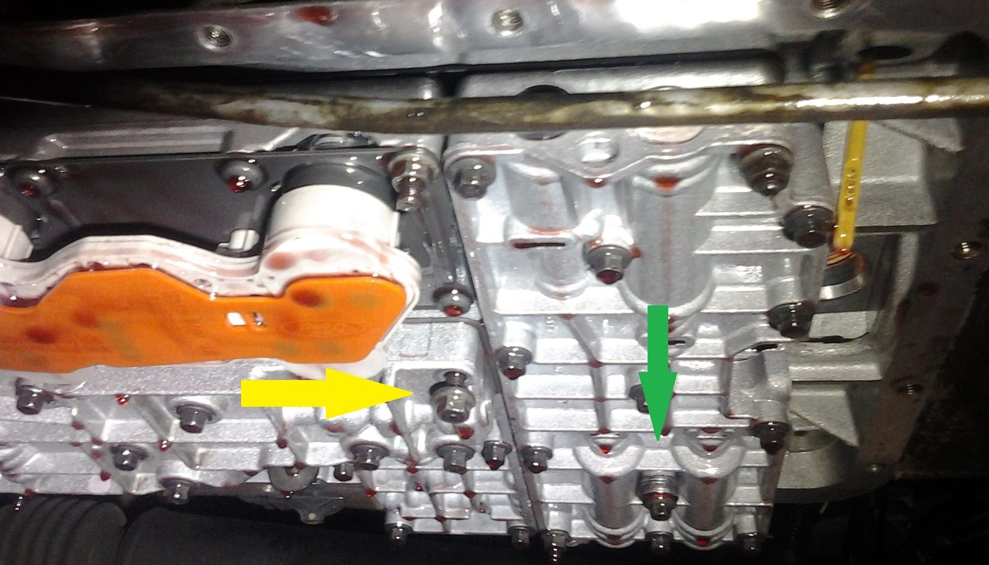

Hi again guys. 95 F250 312,xxx miles with rebuilt auto transmission within the last 10,000 miles. Previous owner said that after the trans rebuild they unhooked the radiator cooler and installed the aftermarket LONG cooler. It is about 11" by 11".
Had problems with some days hard shift 1-2 and 2-3. Also when having hard shift days, it would shift into 4th between 40-45 MPH. Then if I tried to keep it there, it would shutter or shift down or up. I could get it up over 45 and press on the brake and see the RPM change up and then go back down when brake is released. The OD light does not flash, but when pressed, light comes on and truck shifts out of OD. Push it again and it shifts back.
I put a temp sensor in the pressure port and drove 130 miles and the transmission was shifting good that day. It's highest mark was 170* on the hi-way going 70 MPH with air temp around 85-90.
Odometer seemed fine with no bounce except a little quiver at around 50 MPH.
After reading around on forums, I checked and cleaned the VSS and the solenoid wiring on the passenger side of transmission. I never got around to putting a pressure gauge on it.
Fluid smelled a little burnt, but looked clean. I have had worse fluid come out of other trucks that shifted fine. But I decided to change filter and fluid.
The transmission had a cork gasket and some of the pan bolts had fluid drips on them. I dropped the pan and the fluid did seem worse than I had originally thought. Normally when I change fluid I am in such a hurry that I never really inspect things because I am in a hurry to keep the drips from getting on the ground. This time I looked up and noticed the following.
In the pic of the transmission, there is yellow arrow pointing to a nut that has backed off of a stud. I tried to tighten it up, but it seemed stripped out, so I put it back where it was. BTW, it is leaving a mark on the pan. Is this normal?
Also, there is a green arrow pointing to a bolt that has a stack of washers under it. Is this normal?

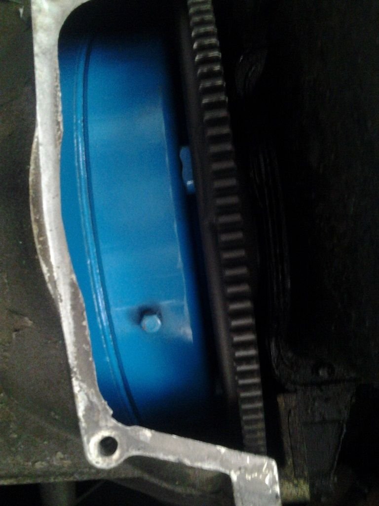

The torque converter did look clean and new.

Whoever installed the valve body didn't know what they were doing. There are different length bolts and they got them wrong. That might be a cause of your problems. If the valve body isn't clamped to the case correctly there can be cross leakage that can cause all sorts of problems.
You need to find the right length bolts. The sipped hole can be fixed with a heli-coil.

Thanks for the reply Mark.
You are thinking the bolt with the washers is too long and that is why they put the washers there?
The stripped part is where the nut goes on the stud. The stud moves a little back and forth, but the nut on it won't tighten up. I don't know if it is the nut or the stud that isn't right. The nut just spins when put at the top. I didn't know if it was some type of plunger and the nut was the stop point or if the nut should have been tight on it too.

i doubt there would have been a receipt.i hope you payed for the truck as if the trans was original.looks as if someone who didn't belong inside a trans was there,replacing a torque converter,and perhaps a shift kit and had a hard time figuring out how it went back together.
with workmanship like that,id suspect re-used converter nuts as well.check them.if any are rounded or loose,be sure to replace them so they don't back out.
the trans should probably just be taken in and inspected for mistakes and corrected if this is out of your area.it's possible it could still be saved for a while if the corrections are fixed.
